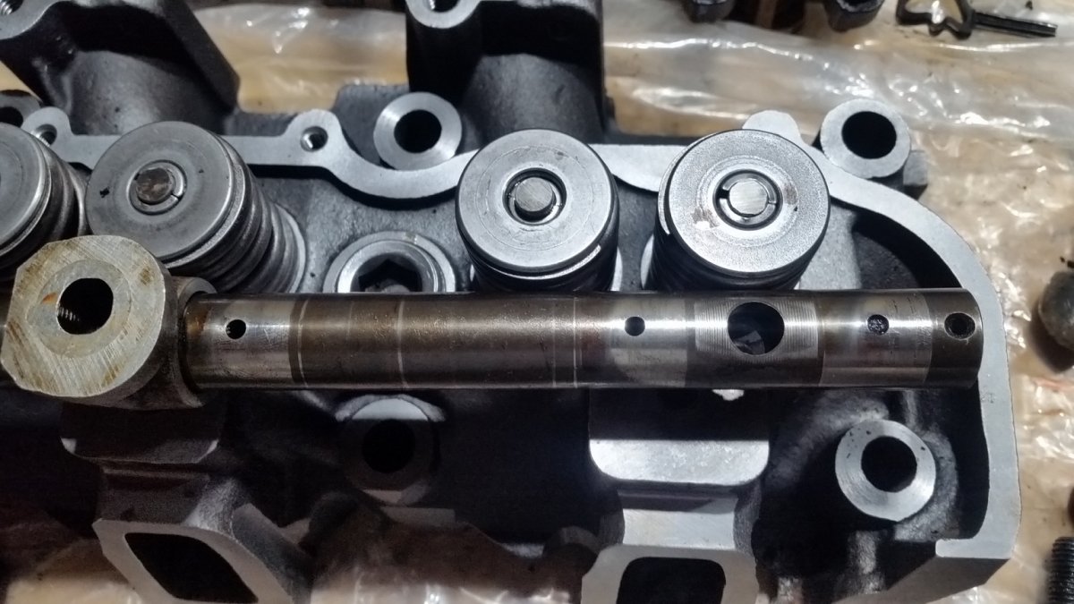

I would imagine that an oil starved rocker arm shaft may cause some kind of noise. Not sure if that would include tapping. The shaft fills with oil and then goes through the holes/ports to the rocker arms (top and bottom of the shaft and rocker). You can see that the far right oil port (which feeds the bottom of the rocker arm) is plugged with what looks like cooked oil or carbon. The other 5 lower ports were plugged also, but I didn't think about taking a picture until I was about to clean out the last one. The shaft is ruined. The lack of lubrication on the bottom of the rockers galled the shaft. I don't recall the upper oil ports being plugged, so some oil was actually getting to the top of the rockers/pushrods.
So, potential causes of the famous 2.9 tick include plugged oil pump pickup screen, weak oil pump, worn main bearings, worn cam bearings, bad lifter(s), plugged rocker arm shafts, worn rocker arms and shaft(s), excessive valve lash, and using a motor oil that has too low of a viscosity when some or all of the above symptoms exist (10W30 appears to be too thin IMO. I've been using Walmart's Super Tech 15W45 with good results). Did I miss anything?
You can clean out the shafts. You drill a hole in the plug in one end, put a metal rod through the hole and knock out the other side, then put the rod in the other side and tap out the plug with the hole drilled in it. Once clear, replace the plugs:
If it's as worn as this one is, I wouldn't recommend re-using it.
