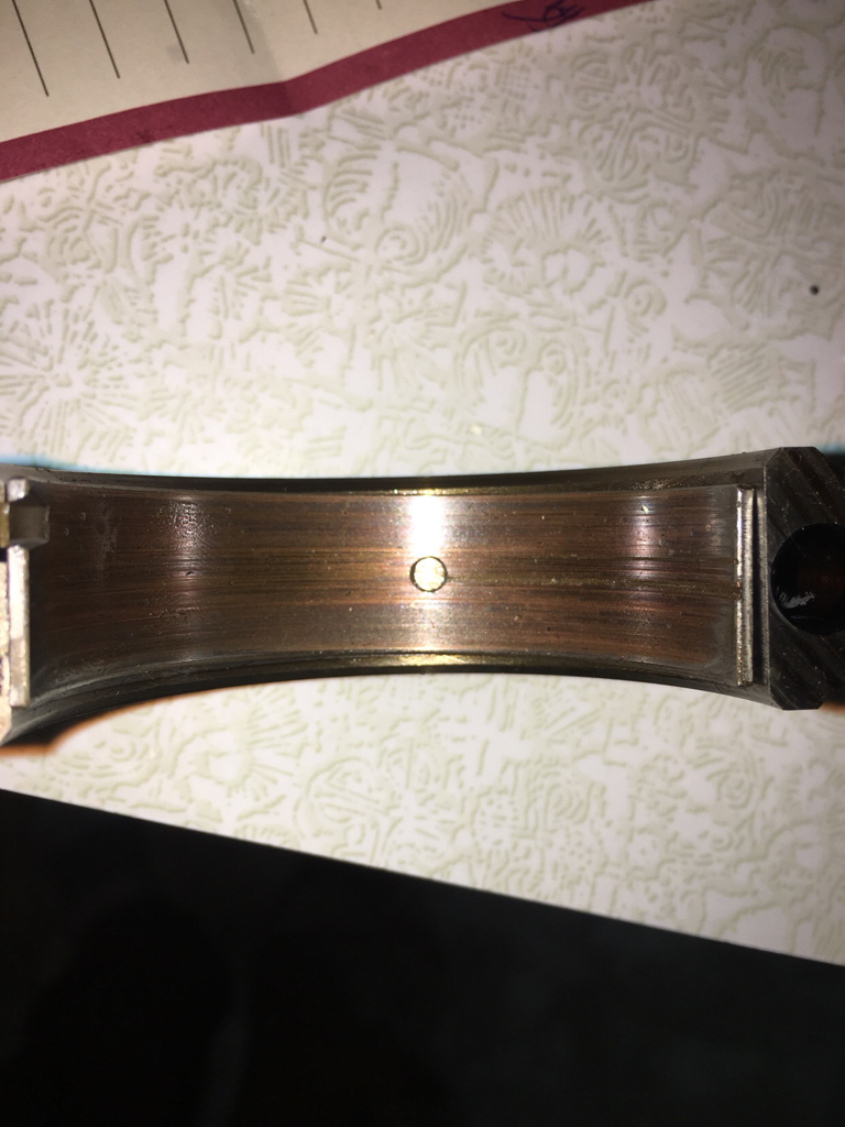

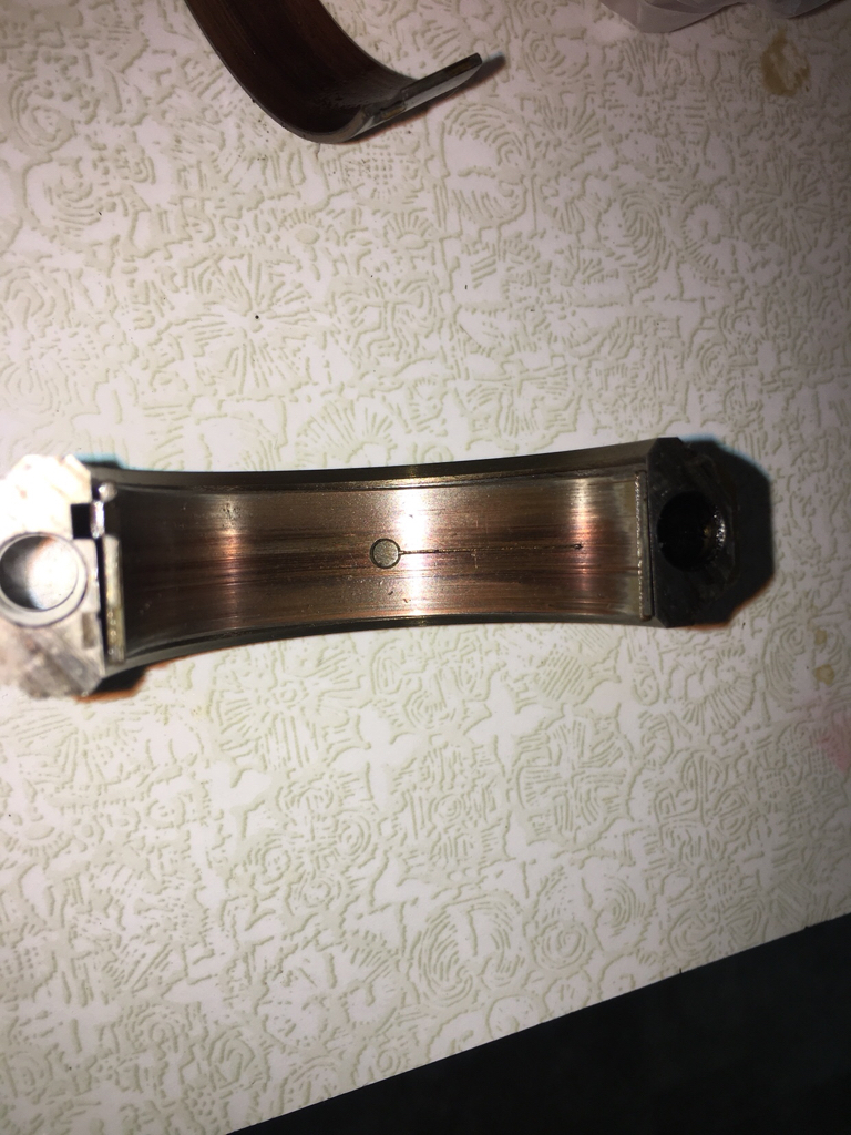

And seen quite a few specs of metal in the oil and pulled the oil pan and checked the rod bearings and there is play in them I’m taking a break right at the moment but I can get them to wiggle front to back and somewhat up and Down I don’t think there should be play like that?
Here is a couple pictures of my rod bearings that are shot I’m thinking of just cleaning up the crank and throw in some new bearings hopefully last 6 months or more?
I did not touch my crank when I rebuilt my motor. As long as you have no pitting/scratches on the crank and it plastigauges out you should be okay. Although it may be smart to give it a "break in period" to allow the bearings and crank to work together. It should work out in your favor. I was also taught that the mains live twice the life as the rod bearings. So you may want to look into those being the rod bearings look that wiped. On the plus side, the bearings aren't bad to install and pretty cheap

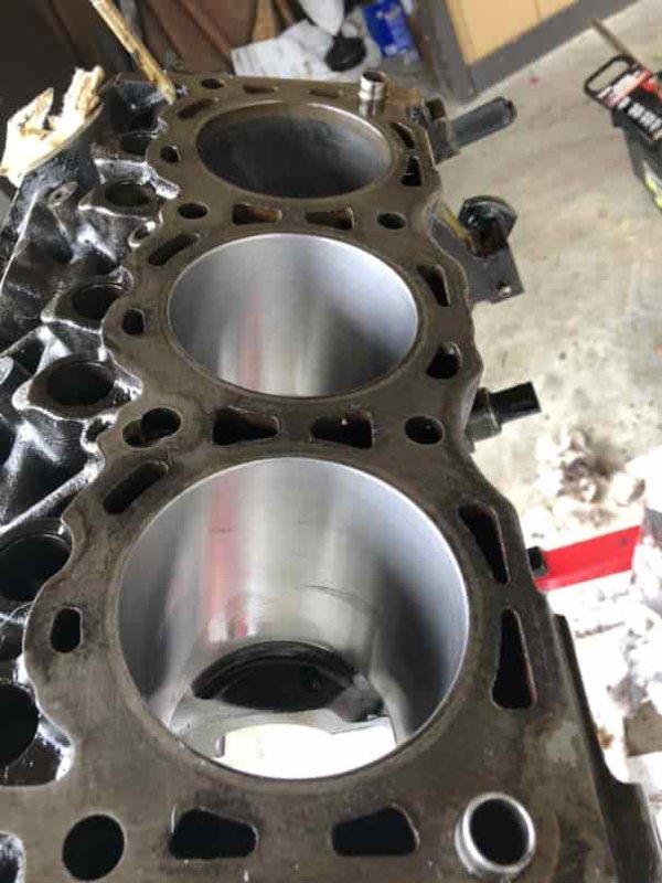

I got one of my short blocks on the engine stand and started checking things out with my telescopic gauge in the bore looking pretty good no ridge inside.
just slightly over 3.66 nothing major when I took the multiple measurements. I started by pulling lifters look to be in decent shape and I pulled the cam and on one of the lobes I can catch a fingernail and the first bearing looked worn not grooves but goldish yellow color. I inspected the rod bearings and they look good, have not checked the mains I am sure they are fine. This has me thinking on the cost a re-ring kit is a 120ish and if I need a cam kit w/ bearings probably also a oil pump as well. the master kit is $450 but If I put that much into it I might as well have it done right by the machine shop which I checked be roughly $500 in work I may as well throw on some new heads as well and you see what I am getting at. I did notice a 4.0 used for $450 but would need a radiator, wiring and messing with under the dash I heard it is easy I don't know about that? I have an auto trans which who knows if I put it behind the 4.0 wear it out quicker.

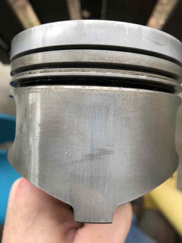

Pistons for the most part still have machine surface showing.

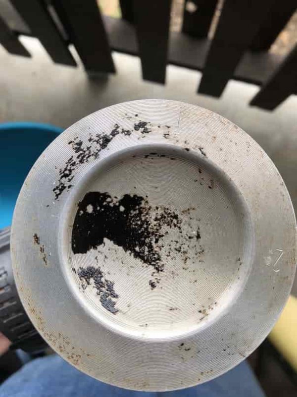

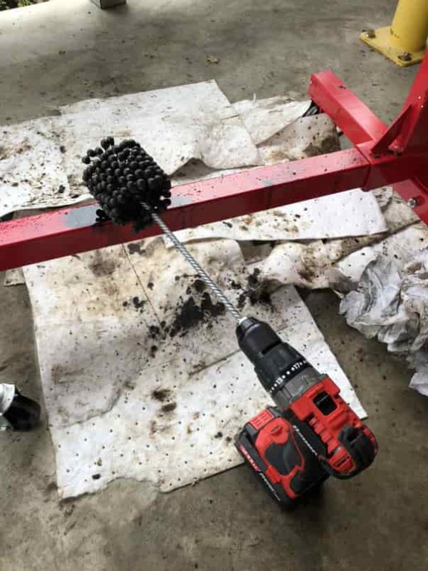

It took a while to get used to the micrometer and telescopic gauge measuring the bores but they were in spec. I cleaned most of the threads on the block and ran ball hone through the cylinders. I have a lot more cleaning to do on the pistons.
