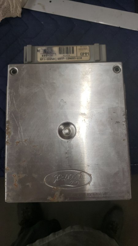

Whats the part number on the ECM?
E8TF-12A650-U1A, that's for the one from my coworker. Here's a picture of the label. It came up as an 88 when I googled it.

E8 is an 88 ECM.
Fords first 2 digits in part numbers is the year that part was designed. The first letter designates decaded (C-60s, D70s, E80s, so on) and the second number is the year within that decade.
So E8 would be...1988.
Why dont you start a new thread here in the 2.9 forum. and itll draw more attention. That way you can get all the smart dudes out to help.
Rock Auto shows that the ECM is an '88 4x4, auto trans, with federal emissions (E8TF-UA). I don't know if the 4x4 will cause any issues in a 2wd. The EGR position sensor (EVP), the EGR solenoid, and the knock sensor should be disconnected when using the '88 or later ECM. It's possible that leaving those sensors/solenoid connected may not be an issue (if their respective pins aren't used on the '88 ECM), but I would disconnect them just to be sure. You should be getting a code 95, because the load side of the fuel pump circuit on an '86 does not go back to pin 8 on the ECM like '88 and later ECM's do. You can also disconnect the vacuum reservoir from the vacuum tree on the intake as it's also part of the EGR system.
