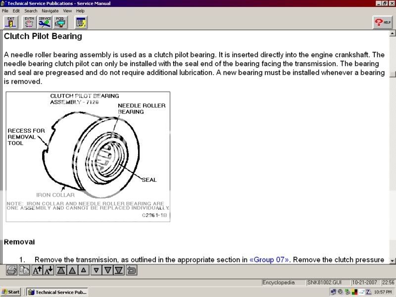

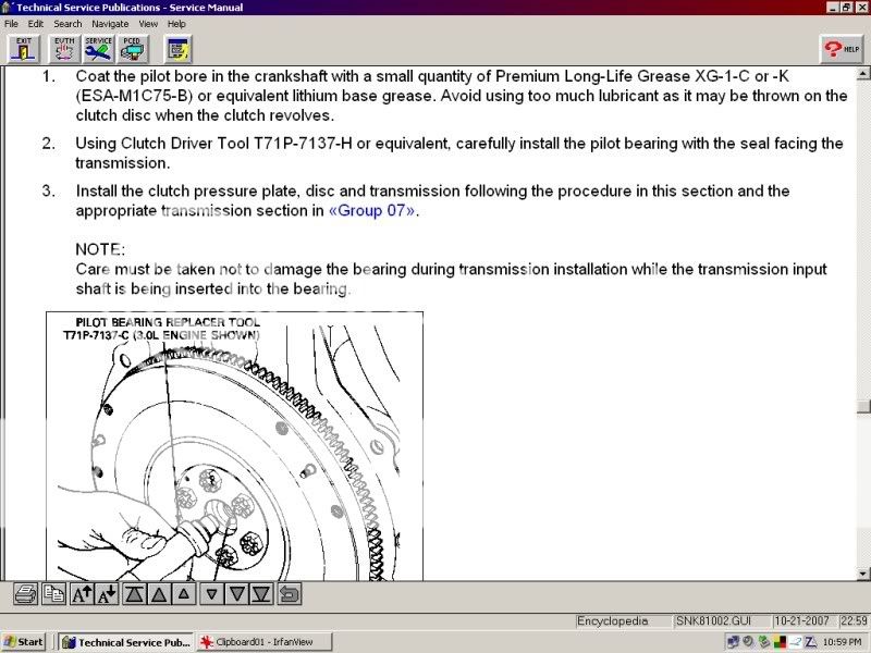

i just checked my old 88-92 2.9l and 91 4.0l flywheels and noticed they have the steel sleeve the little roller bearing sets in neither are like your one piece sleeve/bearing.they both go in the flywheel but i guess if the bearing wound up in the same spot it woulden't matter if the crank or flywheel held the bearing.i haven't seen a factory installed m5od 2.9l truck maybe they use the in crank bearing.either way if the bearing is set further away from the tranny the input shaft would have to be different.what year and model vehicle did you select for those pictures?
Well never mind... I just got back from the yard and the 1992 explorer has the iron bushing and pilot bearing in the flywheel... Guess I get to R&R a trans for the 4th time in my explorer... Sucks. Would have been nice to have had a 4.0 manual vehicle for reference when I did the swap. Oh well. :idiot:
Those are shots from the 1992 Ford shop manual for a 1992 explorer.
