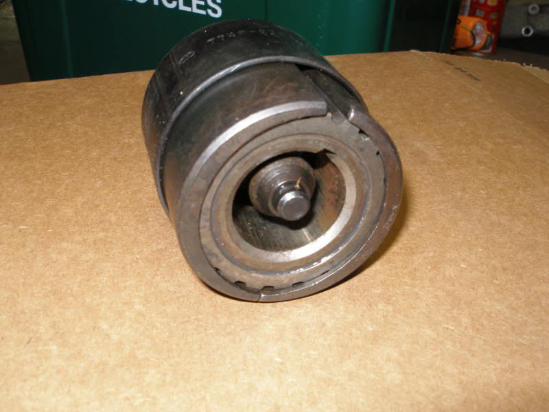

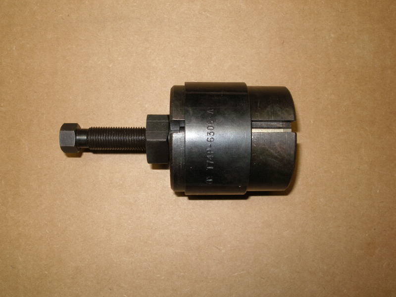

I assume so...OTC made a special Gear removal tool for that function. It could come off with a little encouragement if you're lucky w/o a special tool. I'll include a pic of the tool built for that. I've managed to collect 3 of these in my travels....if you were close by it would only take 5 minutes...the tool is made by OTC/Rotunda....

this tool is a must for working on these older 4 bangers..at least makes the basic tasks very simple...

tool number: T74P-6306-A Remover/Installer, Crankshaft Timing Pulley
