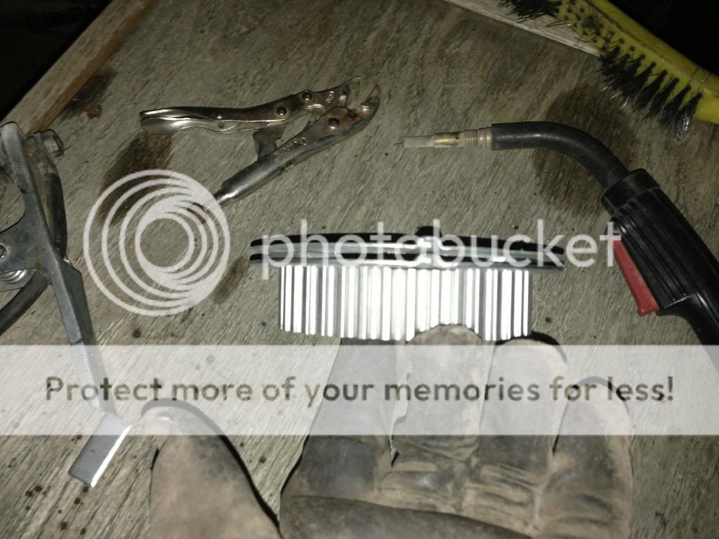

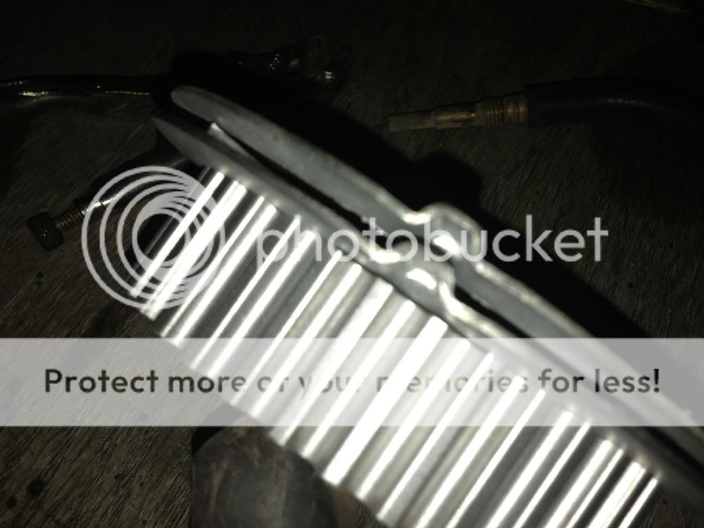

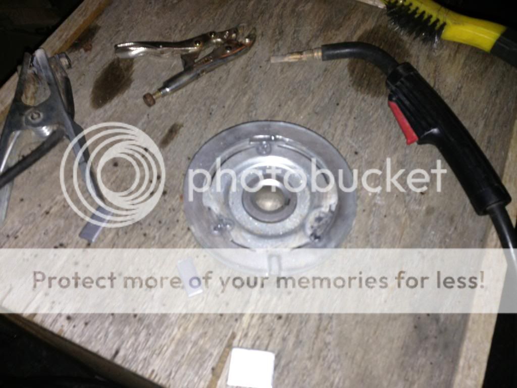

2) P0340 Camshaft Position Sensor: I though I might have a problem with this. I spaced my auxiliary pulley out 3/16 of an inch and the sensor is no longer close enough to pick up the wheel. I have been working on this a little bit tonight and I believe it will be good after this. I hope this is why I have been having Idling issues and loss of power. Here ae some pics of my solution.

I took the back of another pulley and spaced it off of the one I am using. It should be right where I need it now.
