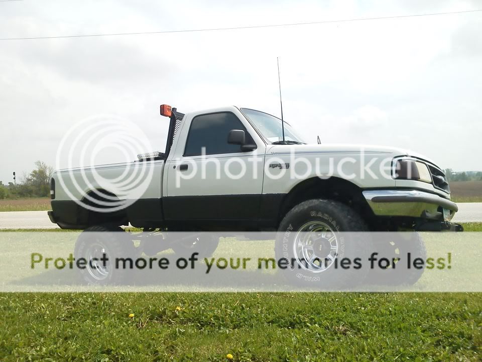

well i have a motor in my sight and not new to fab and motors i build rebuild them and just swapped my ranger to 4wd and lifted it. i am a diesel guy and this is my beater farm truck
and my work truck the older brother lol
