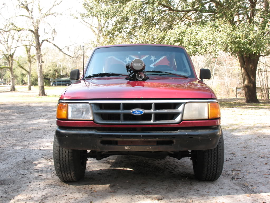

Do this quick and easy mod...
Grumpaw
  • 2.3 needs more power

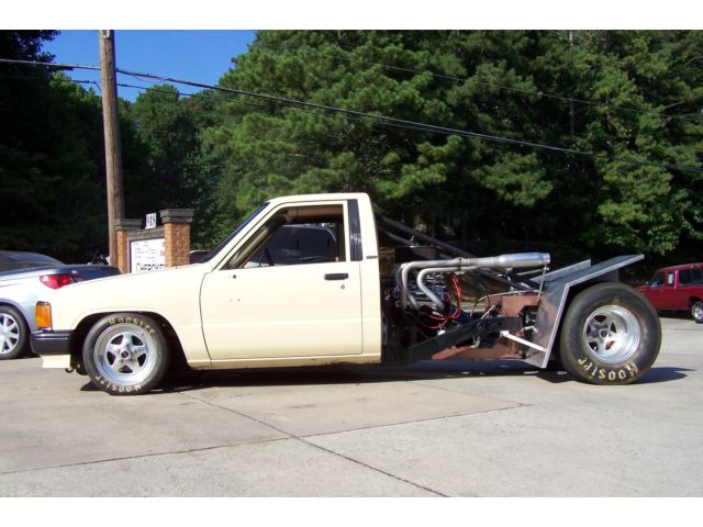

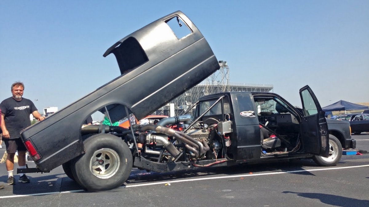

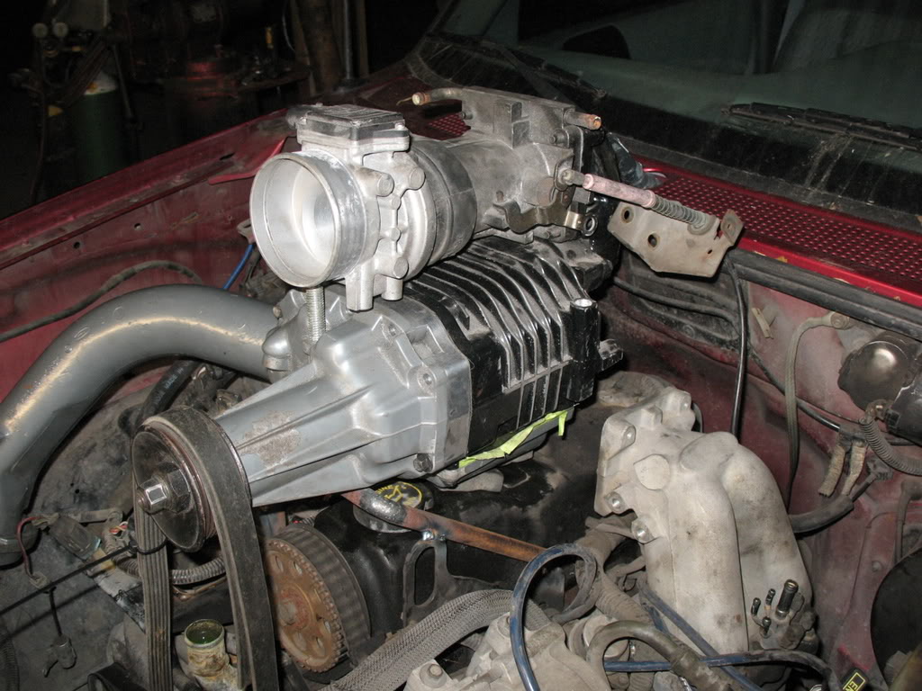

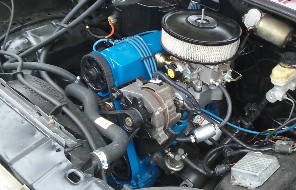

These might be easier....
Just drop the engine between the frame rails, hook up to rear end, a bit of wire and duct tape.
Easy Peasy
Grumpaw
