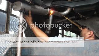

Here's the simple exhaust my muffler guy put together

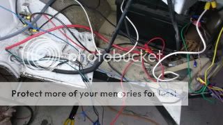

I like spaghetti but not in my truck
2.3 L into 1971 VW single cab
This is more like it-(I moved the battery to the other side)
Awesome! Hope the balance helps...:icon_thumby:
If you saw the spaghetti under my hood you'd probably feel better about what yours looked like...:) Might get mine cleaned up this summer...PsychoPete sent me a new front wire harness with a good clip on it...just haven't been able to tear into it yet...
Thanks Mark, yeah, I never did tie up the wires from my first engine. It looks so much better!
The original harness only has about 4 wires to the engine. I added a brake controller and a few other do-dads which cluttered up the bay.
