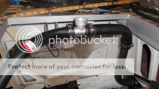

I've been working a couple of hours a night on this. I couldn't load any pics to my photobucket so I didn't report. Finally, it worked so here's some more progress.
I mad many trips to the parts place to get radiator hoses I thought would work. Some did.
We made our own pipes out of some 1 1/2" pipes. Welded a bead around the ends to keep the hoses from slipping off.

Here's a bracket to hold the filler and cap
2.3 L into 1971 VW single cab
Here's the Jeg's filler pipe. It's located at the highest point in the system
Here's the throttle cable bracket my friend made also, just the other side of it is a gold looking thing with a black rubber thing on top of it. That's another valve to relieve air from the system.
I'm also going to have an overflow tank. It's not in there yet.
