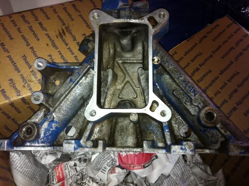

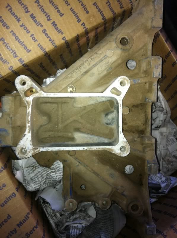

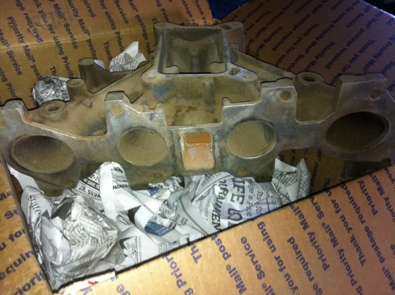

I also received my “Z” oval port intake manifold in the mail today, thought I would share some pictures…
Fresh out the box...

It's blue under there! Well, kinda of...

Well, except for the fact that it is oval port, it is identical to my current intake...mine ends with a -BA...not sure what that means exactly but it looks the same...

Why do they call it a "z" manifold?

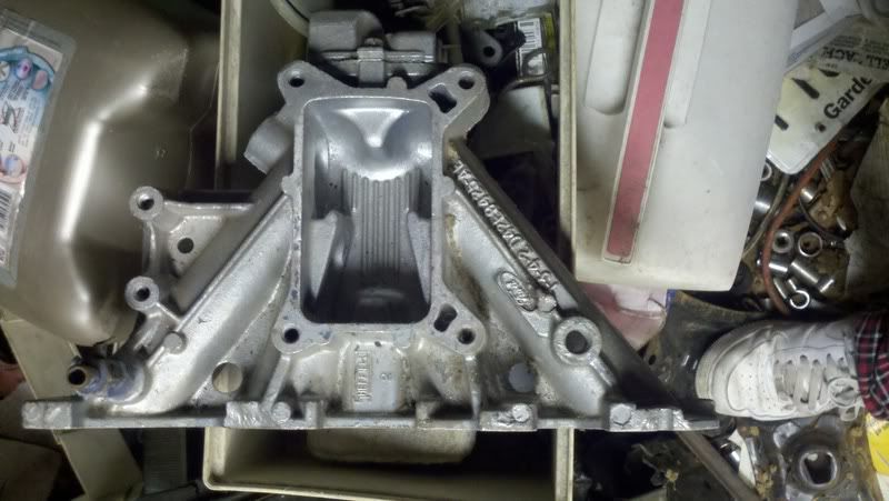

Really, my “Z” port oval would be referred to as a D9 intake, and the one like Mark has, that is the same as mine, except D ports would be referred to as an E1 intake.
From what I have read, there are three choices for stock 2 barrel carb manifolds. The most desired, especially among the mini stock crowd is referred to as a “D4 intake”. The first four digits of the part is the firing order (1-3-4-2), the rest is the casting number. The D is for the decade of the '70s and the 4 means it was first released in 1974. It was used on 2.3's until the D9 was released in 79. Then the E1 came out in 1981, with D-shaped ports for the D-port head. The E1 and D9 have a “Z” pattern on the bottom of the plenum instead of the series of lines like in the D4 intake. The later plenums were smaller in volume as well, making the D4 intake the best stock carb manifold in most people’s opinions.
Here is a picture I found of a D4 intake compared to my D9…

Interesting...mine has the E1ZE prefix...but it came from a 78 mustang...may have been transplanted because when I found it the carb was all shiny and new...like someone just plunked it on and then scrapped the car...
Lots of good information there Drew. Thanks!

No problem, I’m glad to share information! Hopefully it will help others to come, and make decisions easier.
