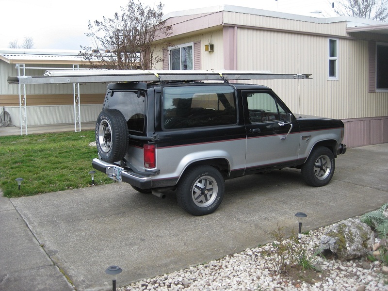

I should have up and running...a 2.3 powered B2...just wanted to add some balance here..I also have an 88 DD 2.9..runs like a top and gets 26+ mpg..no complaints..
In my case i wanted "something different",,that was somewhat minimalist...and when i opened the hood i could "see the ground" and could change pugs easy etc...
I have the m50 4x4 trans from a donor and my B2 is an 87 so i will have to cut the floor for the trans plate...but other than that...it's a bolt in..it may be easier if you got a donor 2.3 harness matching the same year for the wiring interchange..(my donor wiring is 88) but the engine xmember has the holes for the 2.3 mounts already..make sure you get those from the donor...
Sorry if i butted in with an alternative view..but there are a lot of usable 4x4's that have a 100hp...then u could also turbo it....or carb it...for about 120+ hp....
about the weight...find yourself a Ford/SS header from a mid 90's Ford 2.3 and save quite a few lbs..
Of course it may not break drive-lines quite as easily but with a doubler..i'd say go anywhere you'd want to go stayin upright....maybe depends on why you drive a 4x4.....
PS: I sold an "08" Wrangler to drive one of these....and i have two...you can put a lot of stuff in and on a B2
