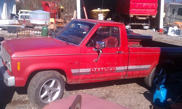

Okay well i Have a 83 ranger diesel and i have decided im going to make it 4x4

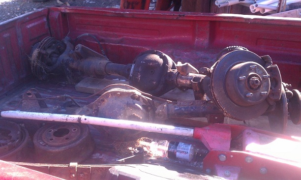

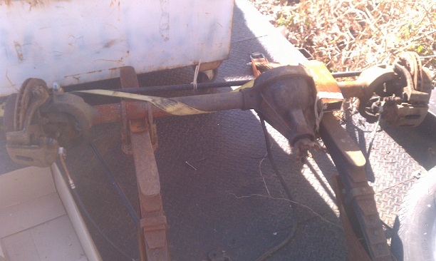

I have bought a dana 30 hp and also a dana 35 rear with 4.10s .
I also got the stock leaf springs and such that i am going to use to use. I dont want it lifted very high. I want to maybe run 32s
For brackets im planning on creating them, shackels in back.

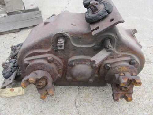

I also bought a dana 24 transfer case. I found out that the transmission was never offered in a 4wd version, so i fixed that.

Thought id put up some pictures of my junk.
i have to wait for the dana 24 to get shipped to me. For now im going to buy my brackets, switch the 4.10's from the VAD axle to the non VAD and check brakes, paint axles and leafs, bolt up what i can etc

Who knows how i hook the cables up to the transfer case?
do yourself a favor and throw that dana 35 as far as you can and keep the 7.5 rear end
better yet, get a Ex 8.8 with disc brakes:icon_thumby::icon_thumby:

I was planning on using the 35, simply beacuse i know my parking brake will hook up, as will my brake lines, and it has matching gears. considering imgetting a custom driveshaft i thought it would be easy/cheep

Yea, the 8.8 would be his best bet. I was just getting at the fact that even the wimpy 7.5 is a better option

A word of caution,
Before spending much on the dana 35 rear to get it to work, google dana 35. There are entire websites dedicated to dana 35 carnage, under jeeps. Get it under a xcab ranger with some big tires, and your askin' for trouble.
If you can make it work for really cheap, go for it, but keep in mind that the axles are relatively light duty.

I was figuring that it would work really cheep. I have about 50 hp max and im planning on running 32's
my thought was the only cost i would have in it is $20 bucks for new spring perches
im going to need a custom driveshaft any way
I guess i could just buy some used gears for a 7.5 that are arround $85 on ebay but the 7.5 isnt that awesome either.
