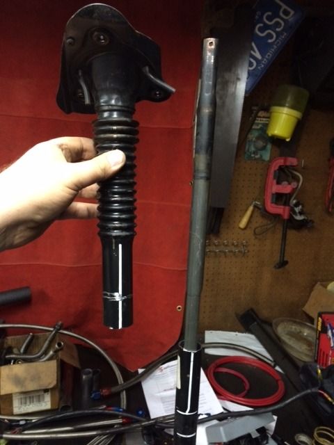

Heres how I did it...
I unplugged and unbolted everything for the column and removed with the wheel still on it.
I marked a center line on the shaft tube to keep my alignment once its cut apart.
Then I used my saw to cut just the outer tube and pulled it off the shaft. There is a bolt at end of the shaft that needs to be removed to slide tube off.
I cut 1.5" off the tube then slid it back together and welded it back up.

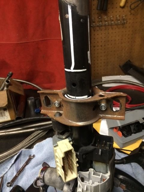

This bracket needs to have the rivets drilled out so it can be slid up the tube. I had it bolted together in this pic but found once back in the truck they interfered with bolting it back up and had to be removed. Just leave this bracket as two parts and use the mounting bolts to hold everything together once its bolted back to the firewall.

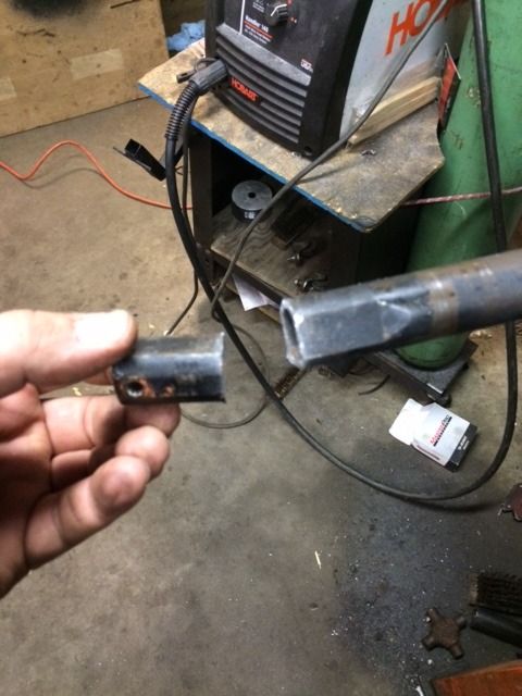

Cut 1.5" off the end of the shaft and I welded a small ball on end to replicate the bolt that was in it.

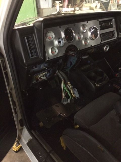

At this length I couldnt have gone another 1/8",its perfect with my dash cluster.
My wiper lever just touches the gauge in the high position.
