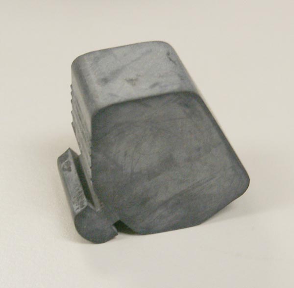

Mine look more like these. Probably Dorman parts or similar..
shopping
While the Ford replacements look a little thicker and more flexible to me..
shopping
GB :)
I'd start there. Mine look more like the second picture. My hood doesn't come up a bunch, but just enough that it seems like something is decompressing under it.
Odd thing, trying to look up first gen adjustable hood bumpers yields no results. I could only find 98-11 stuff. I have noticed that the ones installed in my truck do move around a little too. Like they're a little too small to fit tightly in the square hole in the core support.
BroncoGraveyard is the only place I could find them. I think I'm also missing the rubber bumpers that go along the sides of the hood, but I'm just not sure that the 1st gens had them.

I think my truck missing part #8 is why the hood doesn't pop up a little where you can get your fingers under it. I think I'll just order all of the rubber parts soon, but the bumpers you mention I want to buy oem Ford due to my earlier concerns in my 3rd post.
