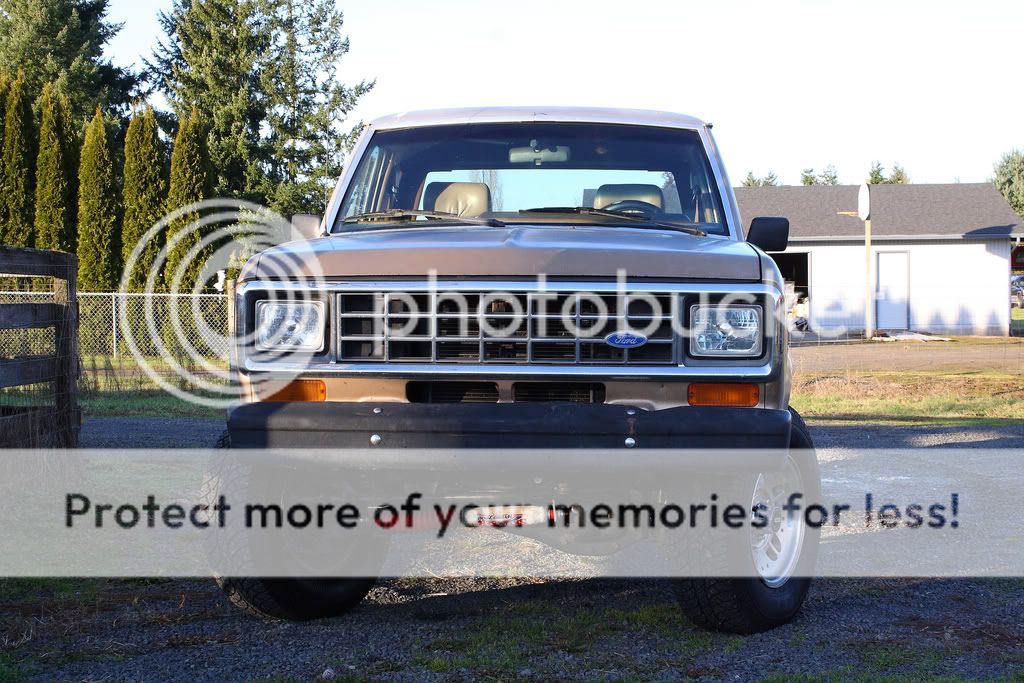

The ones of my truck look great, thy are way brighter.
Here is my problem thy way thy shine the light just does not cover thy road right. tons of light scatter.
I am wanting to go E-code Hella's since thy have nice cut off.
