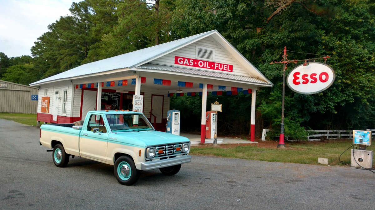

1st Gen fender and hood, on a '90 with a '61 grille
And for fun, '64 grille on an '83 :)
51966
