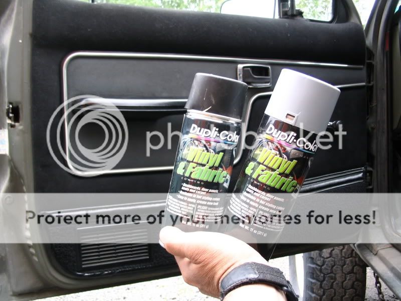

I used Duplicolor on mine and it works good. These panels where originally blue.

Its hit and miss. The vinyl and trim doesn't hold up to rub areas like steering wheels. Trim and bumper is more durable on plastics. Any solvent spill and its gone
Does ok on red carpet. Back trim panel still shines red in direct sunlight. Going to reshoot in bumper black and see what happens. Might even give the balls a tug.
