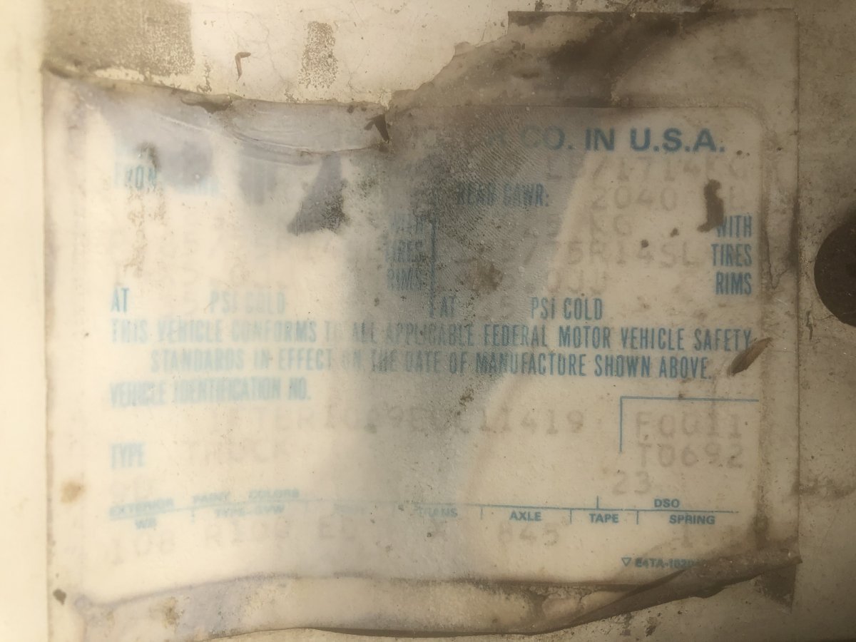

Revisited the mystery Ranger. Tag on front diff says 4 10, axles turn opposite. Rear axles turn same way. No evidence of air bags. ???
Should have taken a photo of the federal sticker in the door.
Upper part of sticker has faded away but will photo what is readable in a few days. Any other tests/observations I can make to help solve the mystery? Front diff possibly changed? Any way to tell if airbags were ever present?
Door was possibly replaced.
Code 84 is 3.45 gears & 5 at the end should be the front limited slip. Although I am unsure as to when you got a front limited slip the rear was also upgraded to an lsd. Front and rear limited slips might have had a code such as F45 with F4 being the 3.45 lsd rear and 5 being front lsd.
A 4.10 lsd rear would have an F7 axle code.
Photo of door sticker is attached.
Most of the sticker is illegible, best I could do.

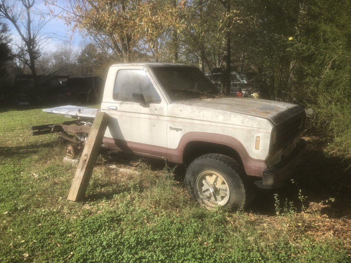

Emissions sticker under hood indicates it's a 1986.
Also attached a photo of the truck itself.
Just now checking my post above & noticed that the sticker seems to indicate that the truck came with 14" tires. Never heard of (or saw) that on a 4 wheel drive Ranger - thought they all came with 15". Mystery deepens..................
