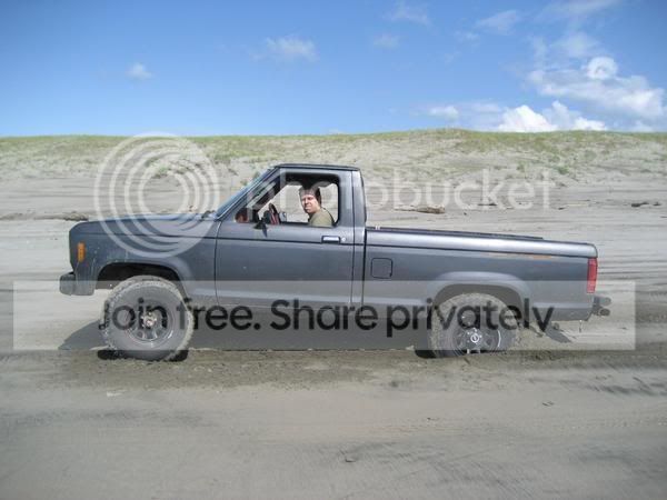

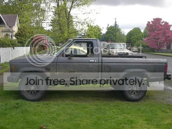

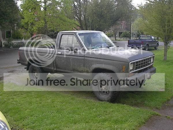

Here is my old 85 BII with 31's. It has a 3" body lift.
But they fit fine before the body lift, just some rubbing when flippin a bitch and with suspension travel. It was fine as a DD tho.
Its not the best pic, as one of tires is on the curb, changing the way the tire fits in the wheel well, sorry, only pic I got.

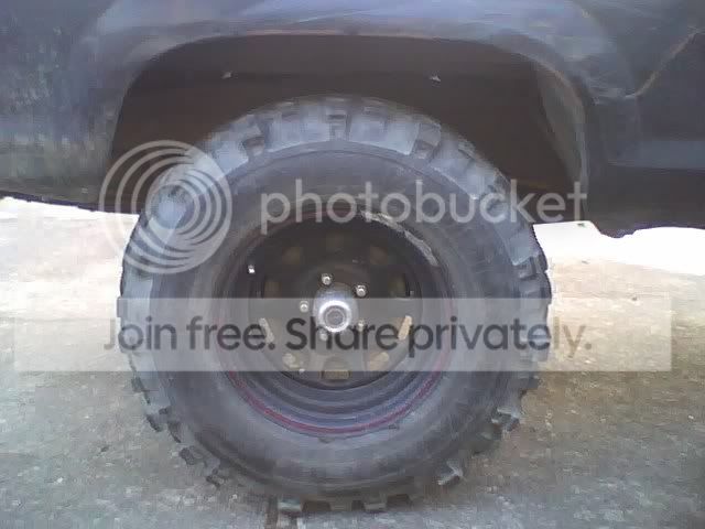

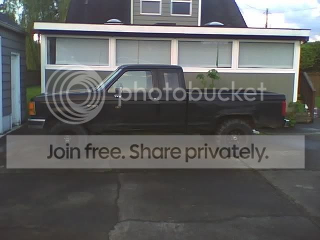

Here are some pictures I just took of my Ranger, I didn't have any with the truck sitting flat, so I went out and took some of it.
1st gen 31"

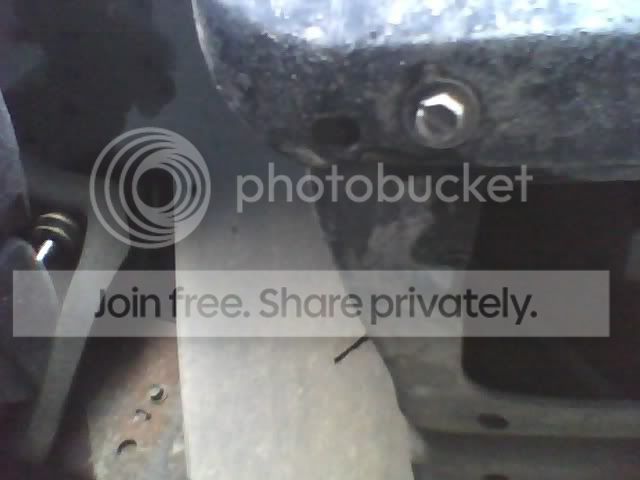

The only place mine rubbed were the plastic inner fender liners, if you look closely, you will see the old screw hole in the fender to the left, and the new one 1 inch back with the screw in it.
1st gen 31"
For the inside, next to the frame, I used a panduit strap (giant zip tie) through an existing hole in the liner, and around the body mount on the frame

The rear at ride height
1st gen 31"
The rear fully tucked
1st gen 31"
NOTE: With 3.75 backspaced rims, the rears will tuck like this one side or the other, because when articulated, the top of the tire will tuck inwards when it moves up. When hauling my quad (roughly 400 lbs), and the suspension compressed equally, the rear tires rubbed the bedsides. I solved this by cutting the outer wheelhouse, and spreading the bedsides outwards by 1.5 inches on each side, adding sheetmetal to the void and welding it up.
Hopefully this helps you out a little, I would personally steer clear of the bodylift for two reasons. 1: it will not increase your actual ground clearance one bit, and 2: you will still have a raked truck.

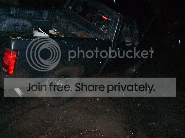

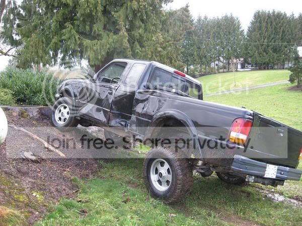

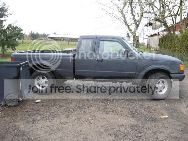

Even with a 3" body lift and 6" suspension you wont be able to clear 35's if you want to be able to flex. If you look at this truck, he wouldn't be able to flex without tearing into the fenders.
1st gen 31"

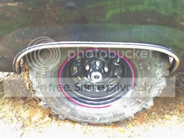

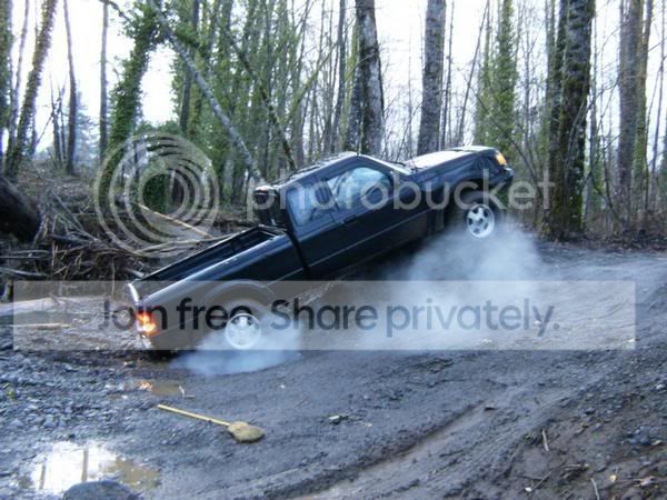

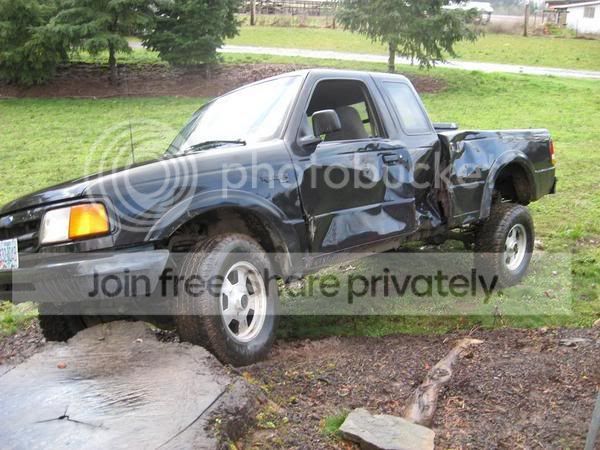

Here is my BII (same fender opening as the Gen I Rangers) with 6" of lift and 31's on the front. It has room to flex, but still rubs the rear of the wheel well opening when flexing and turning.

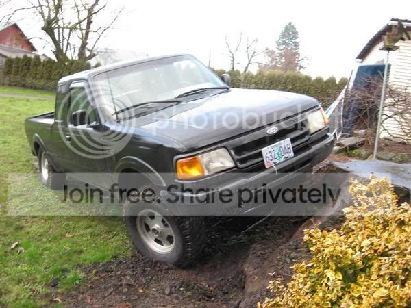

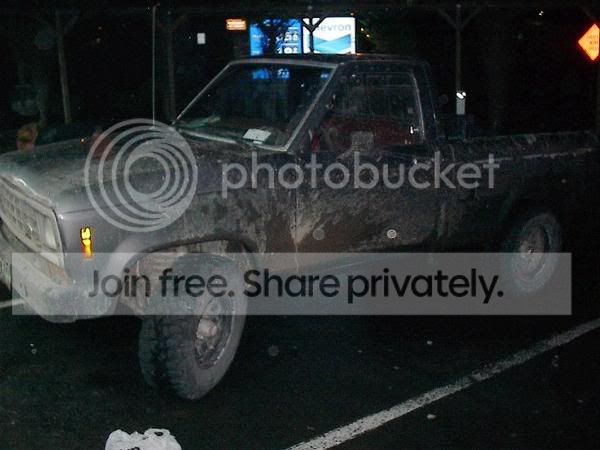

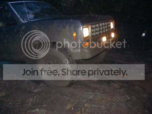

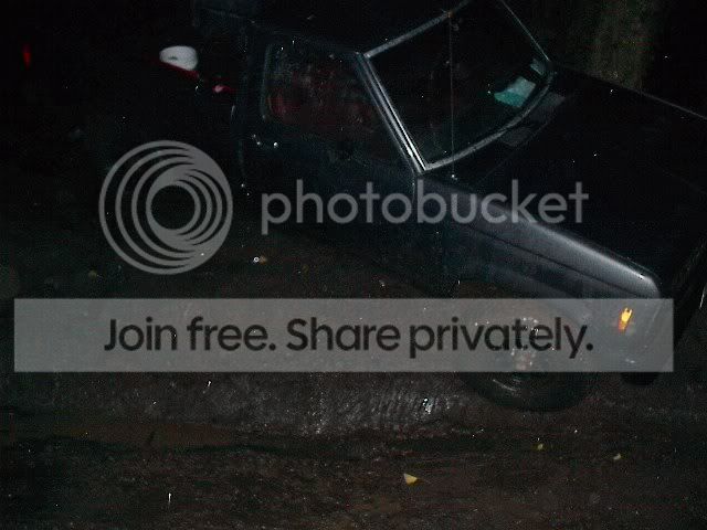

Ok, you can fit 31's under a stock 1st gen, iv had two that had 31's and never rubed even when flexing out.
Heres pics.
This one is my 85 4x4 with a 2.3L...All stock with 31/10.5/15's on 15x7's (No Rub )
1st gen 31"
1st gen 31"
1st gen 31"
1st gen 31"
1st gen 31"
1st gen 31"
1st gen 31"
1st gen 31"
1st gen 31"

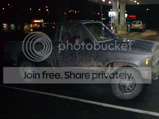

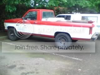

And the red/white one is a 86 4x4 with a 2.9L....All stock With 31/10.5/15's on stock 15x7 jeep rims. ( No Rub ) Is saging a little in rear due to having a set of tires in the bed.
1st gen 31"
But i never had to do any cuting.

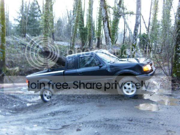

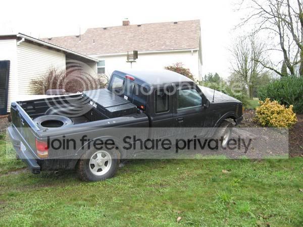

Not a problem, and yes it does depend on what rim offset you use. But they will fit. One thing i saw is that the person that started this thread has a 2wd ranger. They do sit a little lower then the 4wd. i see that "mjones" has a 6" of lift and 31's on the front and rubs when turning & flexing. i have seen when you lift and go flex and turn it seems to push the axle back a little into the fender, plus it looks like he is running 15x8's. But my stock rangers NEVER rubed. I also ran 31's on my stock 93 4x4 ranger with NO rub. So you can say they will rub with out a 2in lift all you want but I have prof that it wont rub on a stock 1st gen 4x4.
