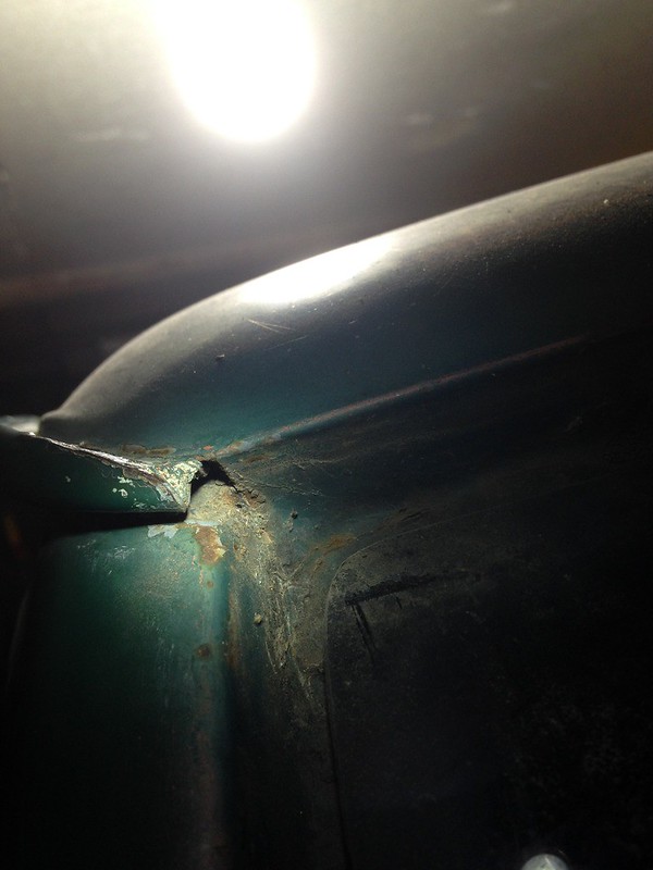

This definitely pertains to 1st gen owners and probably 2nd gen owners as well.
In the course of doing a bunch of body work on a truck, I found a place that is probably the source of many wet headliners and roof rust. This area had seam sealer applied to it at the factory but it was cracked and mostly missing on one side, and just slightly better on the other. Without sealant in the corner of the roof/A pillar, there is a hole that leads directly into the area between the outer roof skin and the inner structure... every time it gets wet, you'll have water in there and I'm sure that contributed to the rust I had to cut out of my roof.
This spot is very hard to find because the windshield trim covers it up for the most part. I used seam sealer to fix it but you could use just about anything to seal it up

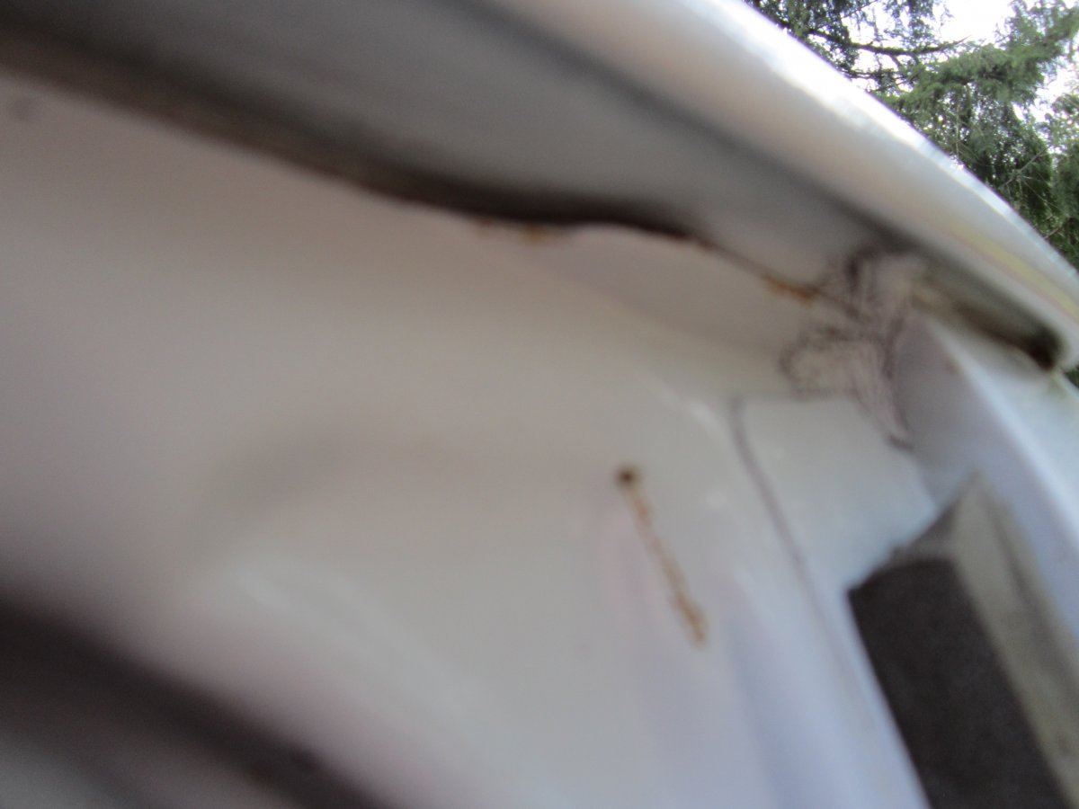

FYI the first pic was an "after" shot. I removed all of the factory seam sealer with a pick. The second shot shows where I reapplied it like it was from the factory.

Is that looking straight on from the front down the passenger side gutter at the top of the windshield? Kinda hard to tell it's so close up. I wanna make sure I haven't missed something on mine.
Yes, it's a very small spot, in the upper corners where the A pillar meets the roof skin near the front end of the drip rail. The hole is about the size of the head on a pin... 1/8" maybe. Small enough to easily overlook with the windshield trim in place, big enough to let a lot of water in.
I know exactly the spot you are talking about lol.
The cab is full of these, I found one the seam sealer dried up and left down under the windshield trim at the bottom of the drivers side corner of the windshield too.
Yeah! That's a way better picture. I couldn't get my camera to focus like that.
I'm sure the lower seams on mine are dried up too, I'm working my way down towards that area. I wish the cowls were removable like they are on full size trucks, it sure would be nice to get in there and run a bead along the bottom inside of that!
