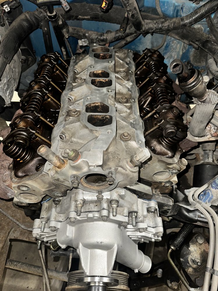

The pic is what I went thru on my 97 B-series (same as the ranger) but I had a significant timing cover leak on top of a misfire etc…
