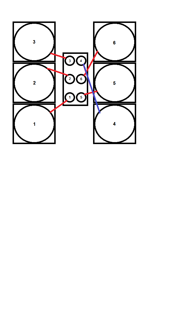

8 Place long drinking straws into Block bolt holes
This is to help align the cylinder head with minimal scuffing
9 Install Cylinder Head to Block using straws as guides Ensure that the Cylinder Head is properly seated, you'll know

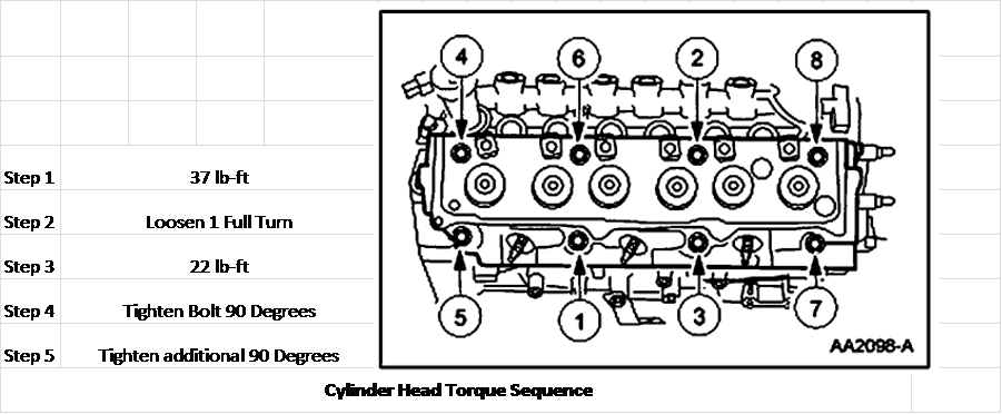

10d Install Head Bolts by hand
10e Follow Torquing Sequence
Smooth motions, angle gauge highly suggested

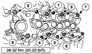

18 Align new intake manifold gaskets to heads
Tip: a dab of RTV or adhesive can maintain positioning
19 Lower the LIM straight down into place
helps avoid misaligning gaskets
20 Bolt down following proper torquing sequence
6 bolts

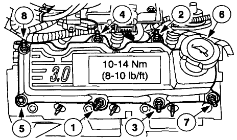

24 Replace valve cover seals around bolts
most kits include these
25 Clean Surfaces
gentle solvent and plastic razor on plastic cover
26 RTV at mating surfaces
time sensitive, do one side at a time if unsure
27 Bolt down, follow torque sequence
8 bolts per cover

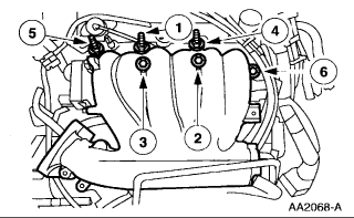

30 Install removed accessories, vacuum lines, and cabling to UIM
Easier to do before installing UIM like bracket & PCV hose
29 Align and install new plenum gasket on LIM
29a place UIM onto gasket and LIM
29b lightly tighten bolts by hand to hold in place
30 Tighten down following torque procedure
1999 Ranger V6 3.0 FFV Head Gasket Walk-Through
Upper Intake Manifold Torque: Stage 1 - 14 lb-ft | Stage 2 - 18 lb-ft
