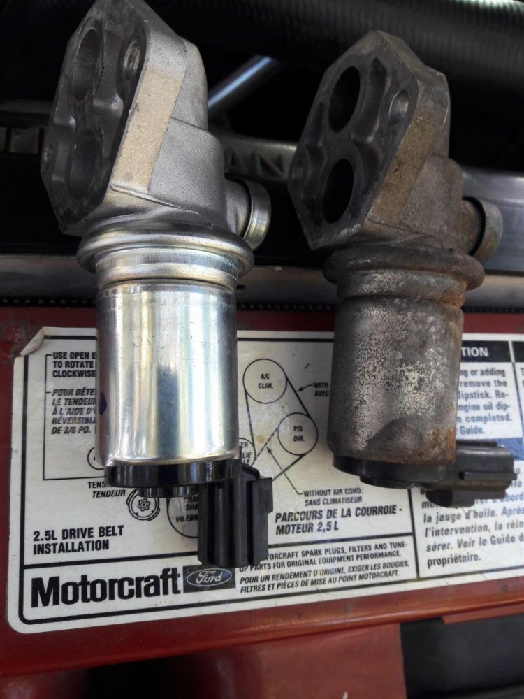

1999 Mazda/Ford intermittent near stall and stall at red lights and after coming to stop...
I drive a 99 2.5L ranger should be the same thing. Only prob is I don't have a tach. But I can get my live data scanner back from my friend and gather info for you if you'd like? Also if you can't find a genuine motorcraft IAC I can pull one from my local yard and check its function off my truck then Mail it to you.
Oh, great, I'd appreciate that! I got the wrong part (IAC) from a well known auto-parts dealer and am going through the pain in the (you know what) return process of the IAC. Any live data would help since that's probably my next step is to have a live scan if possible. Please direct private mail if you can get the live scan data and if you are able to find a good/salvaged IAC. Thanks again for reply from Ohio!!
