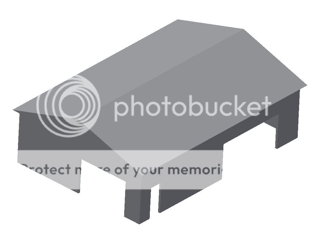

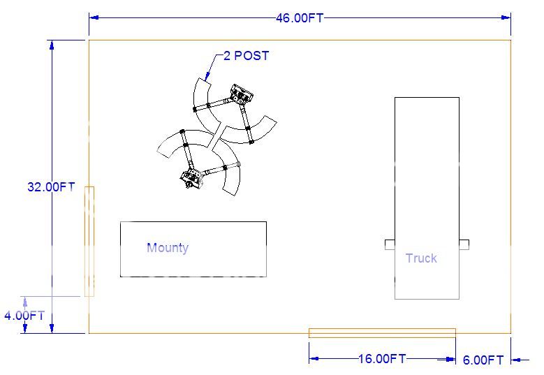

Currently working on a new outbuilding to replace this one. I am allowed 1500 sq ft without causing a bi*ch session with the city. I am leaning towards knocking this one down and starting over vs adding on and raising the roof of the current 30 year old pole building. Currently chasing down cost for a 32x46x12. 14 tall if the township will let me. Max height is a percentage of your house height.
The last garage was 32x40 with 2 doors on the short side. I disliked the flexibility of moving things around with that setup.

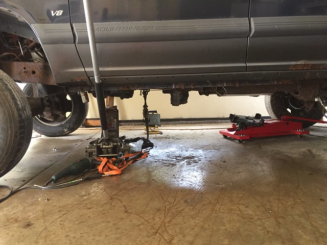

ZF is in. 1356 is in. I need to install a clock ring on the 1356. It hangs way low. I will get some pictures up loaded to night. Not much progress over this long period of time.
Sliders are welded. Just haven't been installed. Need to work up the urge to weld plates to my new frame...

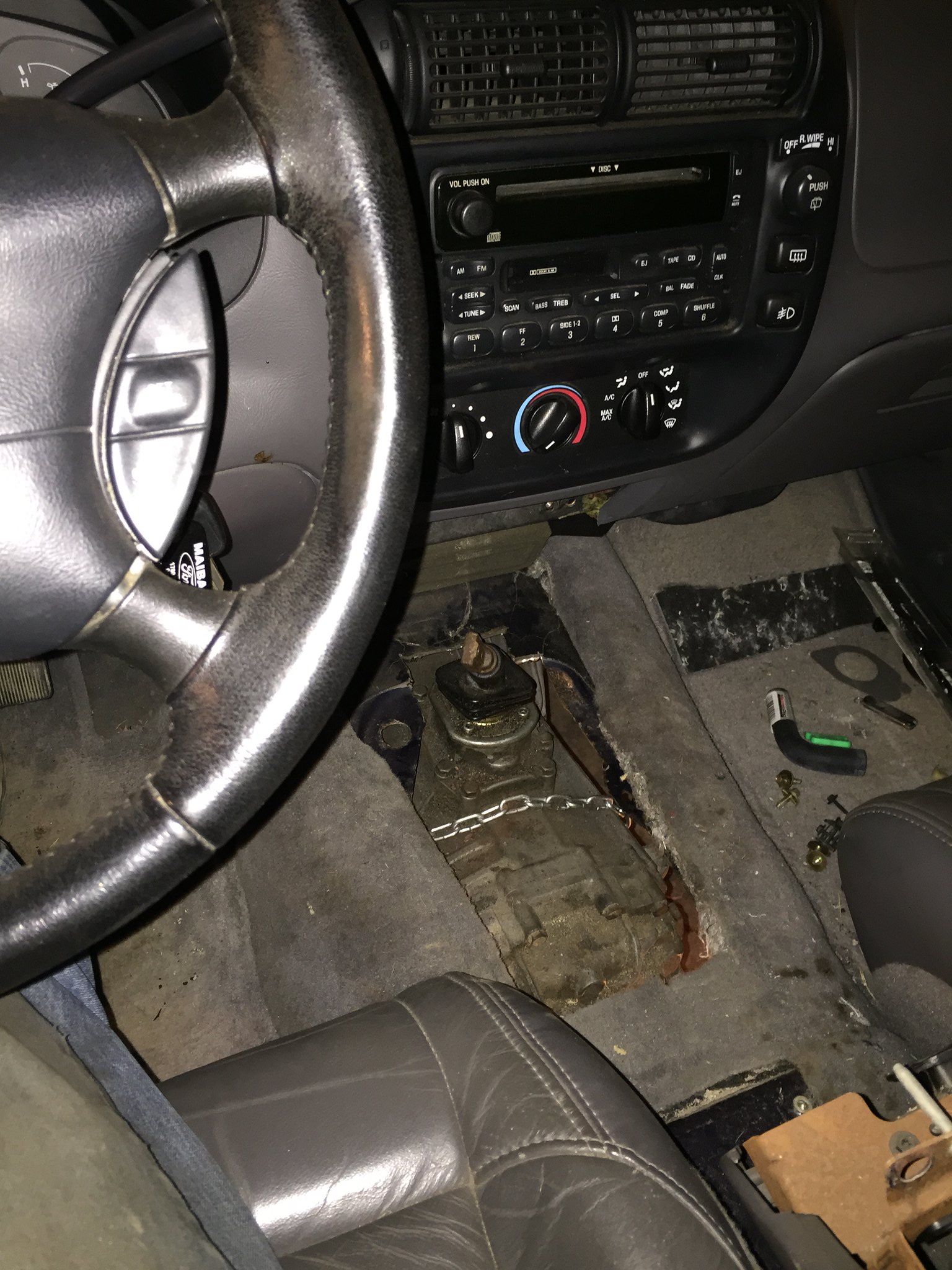

Got the ZF5 bolted in. I had to cut a few unneeded tabs off the bell housing and the tunnel near the gas pedal needed some BFH love.
Then got the 1356 bolted in. The frame needed a little notch. It does hang down lower than I would like. I bought a clock ring from Great Lakes Off Road. Need to get that installed.
Next on the list is to get a trans X-member fabricated up.
