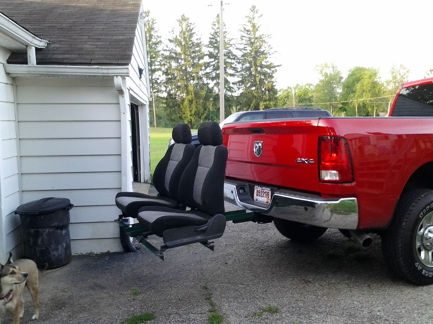

Went to Carlisle Truck Nationals last weekend. Good times as usual.
However, this year I had a road ready truck. Usually I am scrambling around fixing little stuff to make the 800+ mile round trip.

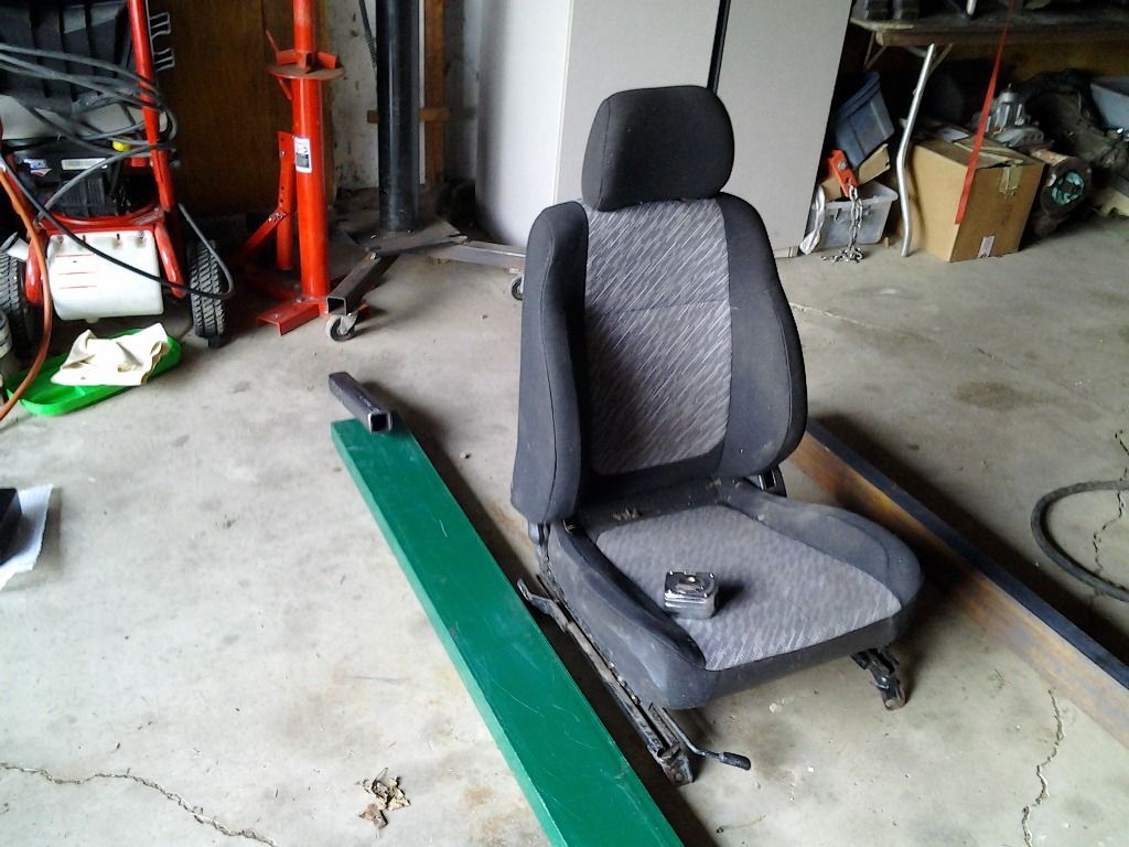

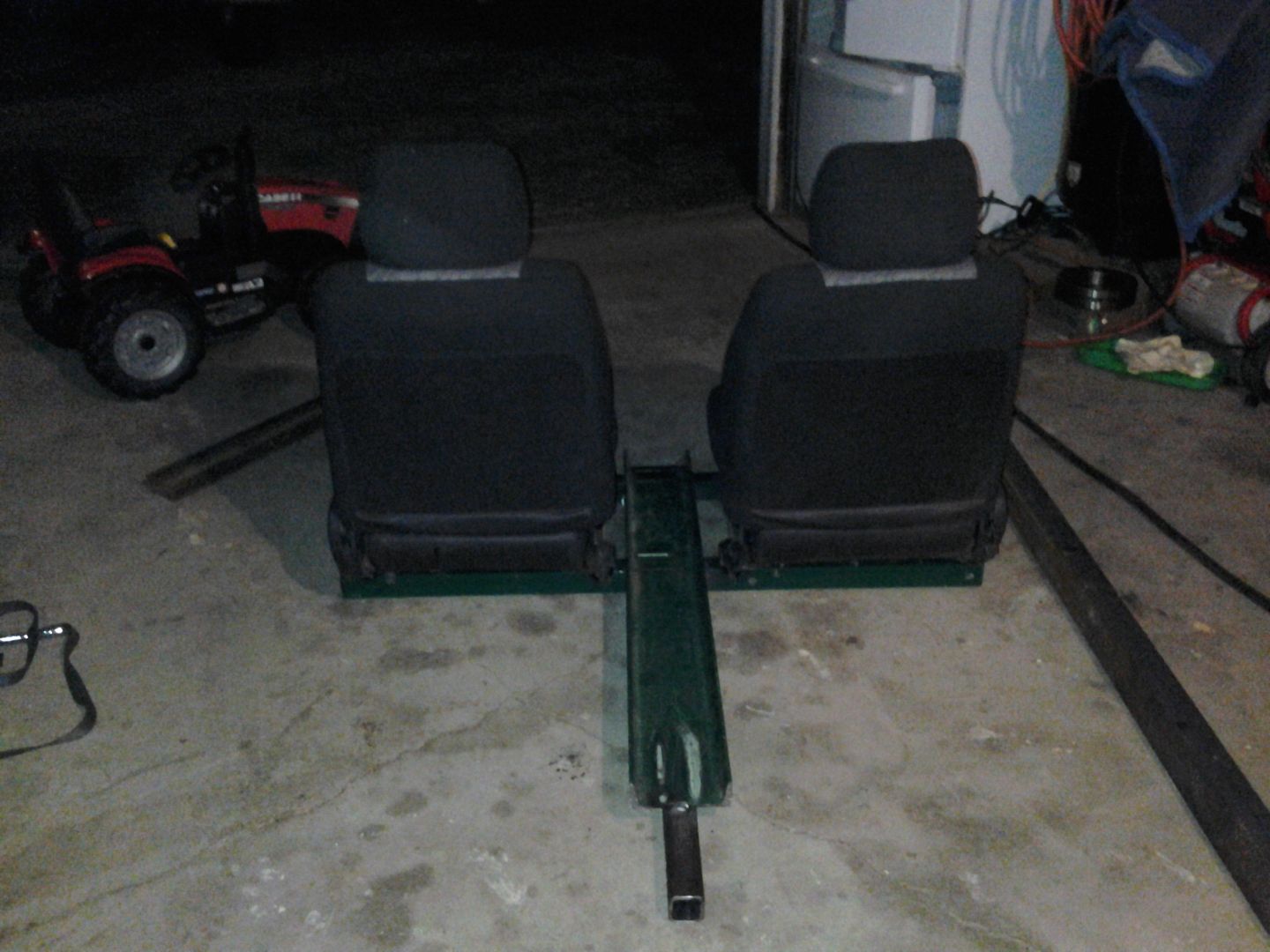

So I dug some seats out of the barn and welded up a frame at 11pm the night before I left lol. Boom, cruising hitch seats. They were a hit! And much stronger than expected. 250# guys were jumping on it like a diving board all day. No issues.
Next year it was requested I add an umbrella and cup holders. But hopefully its on the back of the Mounty and the hatch can be used as a sun barrier.

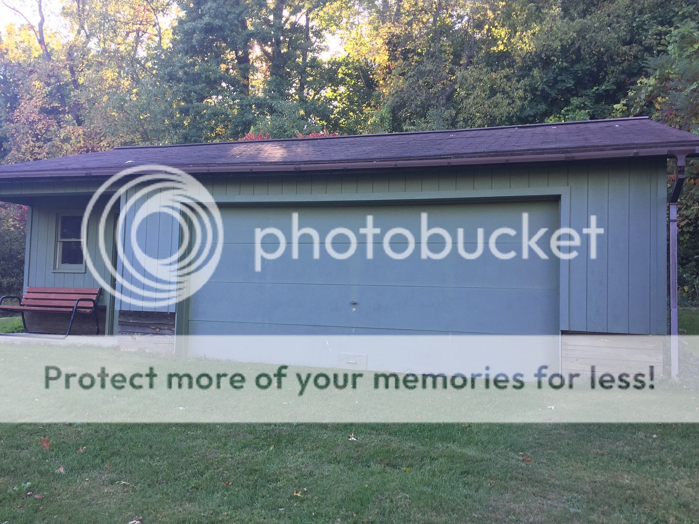

Not sure what I am going to do with the new place. Might even knock it down and build a whole new building next fall. It is a basic pole building built in 1986. It does have 60amp service. Its 32 wide by 24 deep x 8 tall. I want a 40 wide x 32 deep x 12+ high. Or I might just add a high bay and go from there. In this area I am allowed up to 1500 sq ft without a variance. That is plenty big for what I need.

New digs. One owner. 1958. The inside is still, nineteen fifty eight. But the bones are there.
