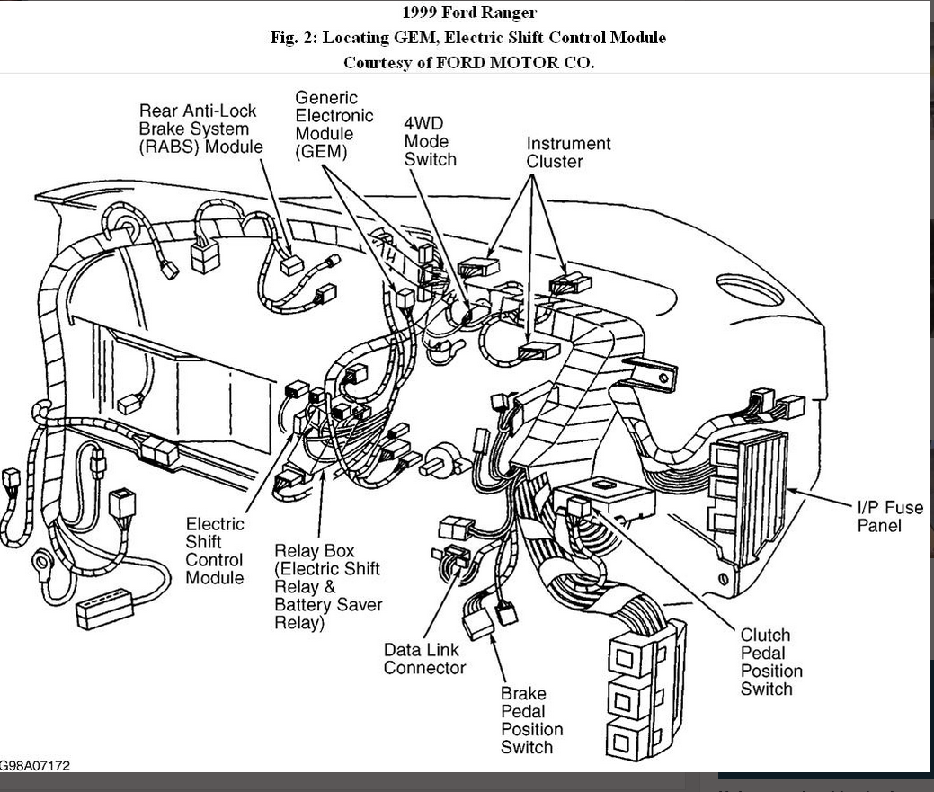

Break open the connector underneath the Driver's Seat - clean it with Electrical Contact Cleaner and then use a bunch of Di-Electric Grease when putting it back together.
If you do this every couple years, it will last forever.
Or buy a used 2001 from Minnesota that was never cared for and have to splice all the wires together because the corrosion was so bad...
Cab light sticks on oil your door latches and pivots.....get a oil squirter from ACE and get full synthetic 10w 20 or 5w 20 and use that.......but yes wiring on these damn +1998 trucks sucks.....and trans is meh......I has the 3.0l with the 4 speed auto.....I think its the fully electronic 4 speed auto cuz I forgot the technical name....my heater that I rarely use in Florida never seems to cause any problems.....
Here's the wiring bundle diagram for the electronic trans.
  • 1998 & Newer specific Ranger problems.....
