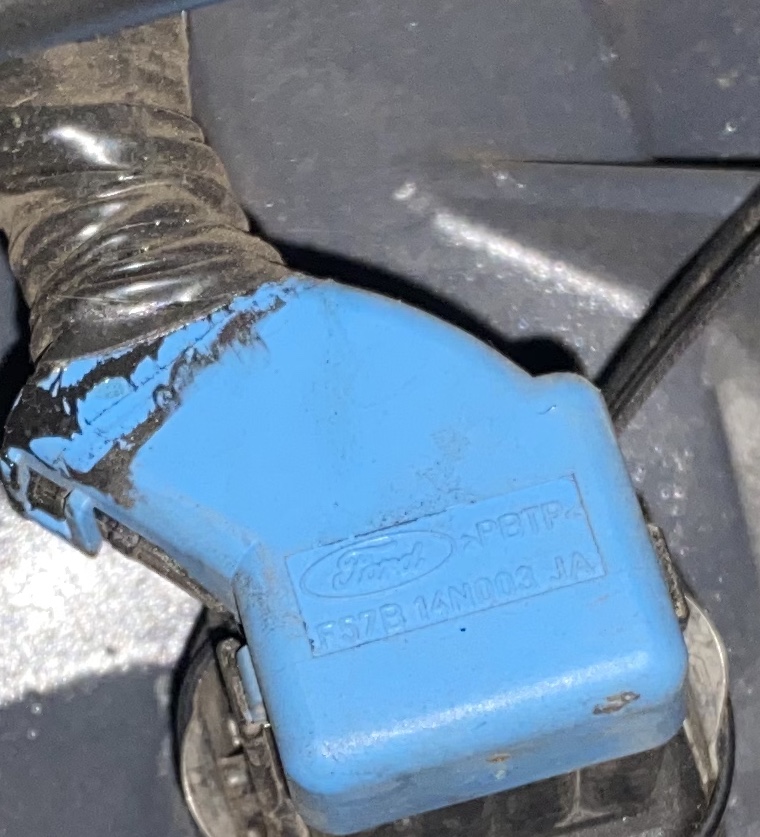

I am having a speedometer issue. My transmission overdrive (Im assuming an electrical connector) is having a problem, and now my speedometer is having a problem separately.
First I have had an issue of RPM loss, and loss of power going up any tiny climb or grade, I can be in overdrive at 60mph , to 70 mph, my truck loses rpm fast going up hill....I drop from 70 to 60 mph within 10 seconds,.
my engine is rebuilt by a 5 star engine house, my transmission similarly rebuilt by a 5 star transmission house..... this shouldnt be happening. I do have what I think is a bad wiring harness that connects to the outside of the internal transmission electrical harness, the connectors or wires externally seem to short when it rains, and I lose overdrive immediately in the rain . Aside from that , my speedometer began to "slip" at 40-50 mph , it doesnt respond then sometimes it jumps up to the mph of 50, or it slips rapidly down to 40 despite constant speed. Is this speedometer issue the gear sensor? Or is this related to actual transmission slipping? my RPM stays constant when the speedometer slips. These two issues seem separated. I already changed the rear differential speed sensor....I know there is a shaft output sensor, and a gear for the trans...
does anyone know a thing about the transmission electrical harness and overdrive? I cant find a single diagram or part name for the harness plug

Anywhoozle, yes that connection is prone to damage from water intrusion. Id pull it off and clean the hell out of it and then coat it with dielectric grease. The digital range sensor is also something to check. I've seen the range sensor plastic warp/crack and water gets in. A bad range sensor can cause all sorts of goofy issues.

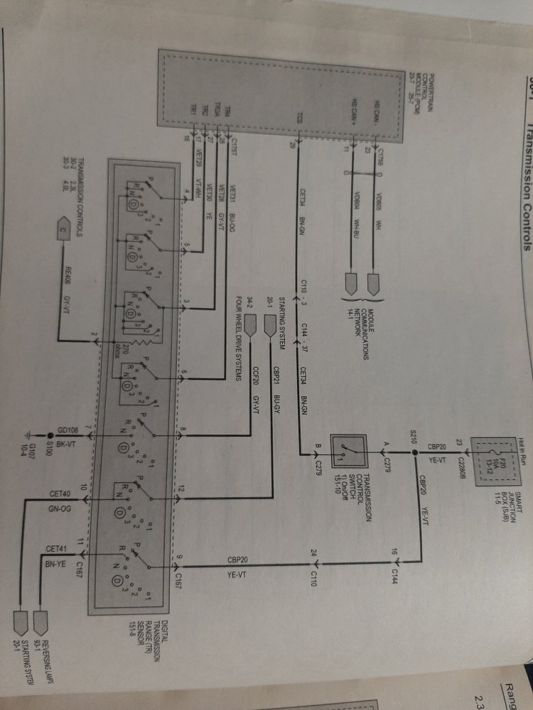

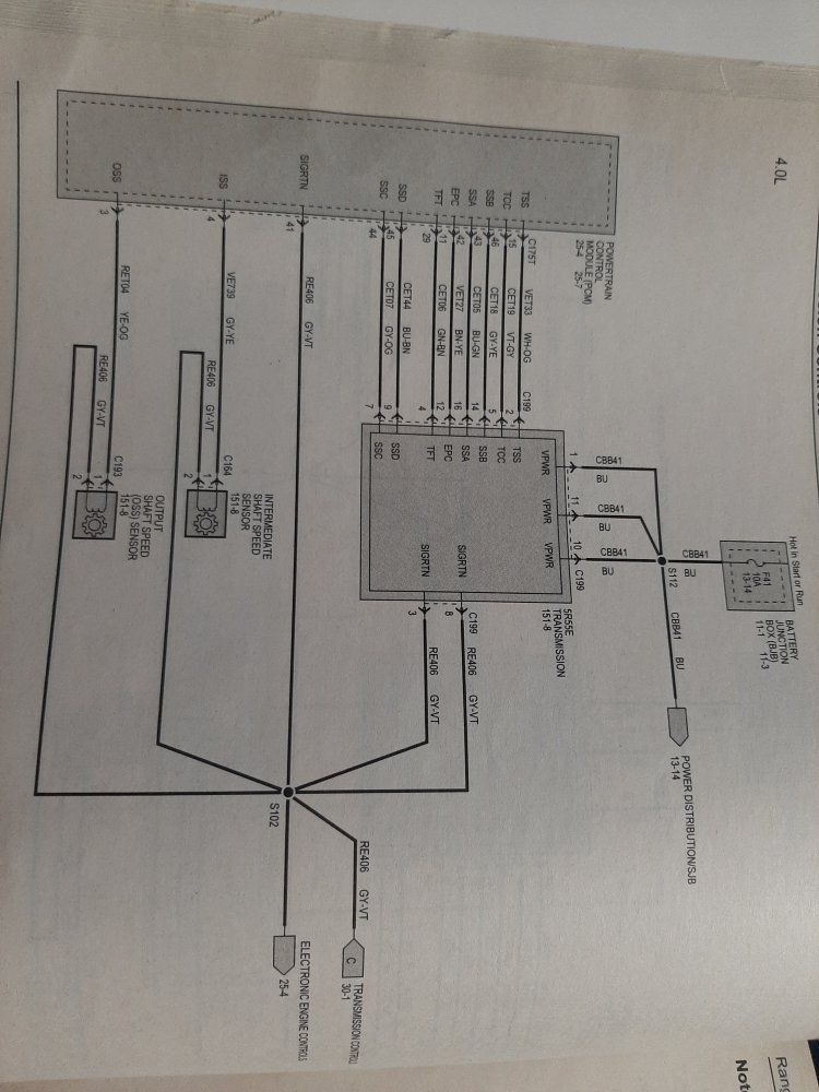

Here's the best I have for a diagram of the trans wiring, this is for a newer 5r though (you dont have an ISS sensor) if this diagram is at all helpful I can actually scan it to make a better copy but I think cleaning the connection and checking/testing the DRS will be the ticket.

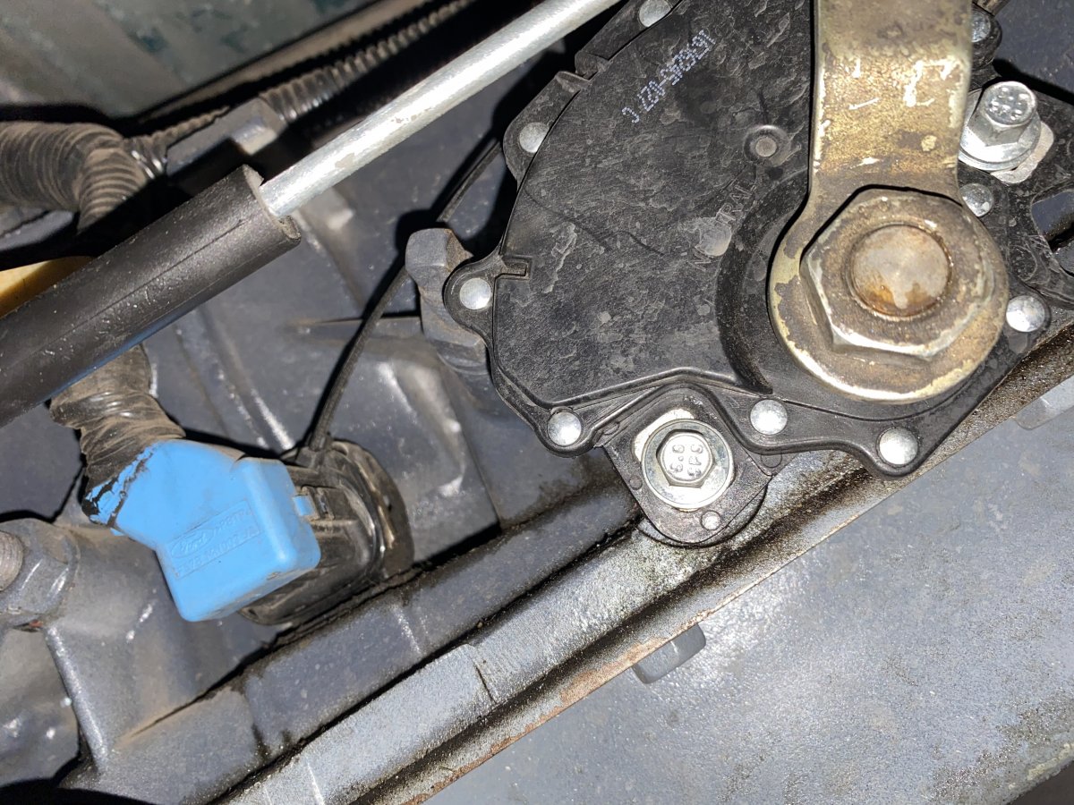

The DRS is where my shift lever is connected, the lever seems to be out of place slightly, yet there is no way to adjust it....thats another issue too. I adjusted the lever last year, it came lose again, so my park indicator is off and I have to press the lever aggressively to the left while in park to start . or start in neutral. The digital range sensor is 1 year new....or old whichever you would perceive. I noticed that my shift lever cable was baking on the exhaust manifold, and burned on one part of the cable, do you think this heat could have transferred and fried some of the DRS from its connection bolt?
Ok before you go nuts you need to start over with getting the cable, range sensor, and dash indicator in line... if the DRS is out of whack it will throw everything off and there's no point going any further until you know it's in adjustment.

Get it adjusted and then see if that cures the issue before moving on. The DRS is basically just a switch but it does have some resistors in it that can go bad or get corroded. But if not adjusted it will send improper data to the ECU and cause all sorts of issues.
Also check that the shift tube bolts under the steering column are tight. This gets loose and causes shifter issues (shift lever out of whack). Super common issue.

scary stuff happened today. I thought my manual brake cable would hold the truck. I was removing the lever off the DRS...and my truck rolled , I rolled right out from under, and it rolled into the middle of my street... FML. Anyhow... I reconnected it and got it the F out of there and put extra wheel chocks and a jackstand on the axle. I couldnt find any Overdrive Drum Sensor on my transmission ...there is nothing near the side of the case, is this an internal ODS? Also my transmission harness plug is wobbly, even while plugged in. Ill have to get under there and re-align the DRS when im over the rolling truck situation
The ODS is up top by the bell housing but were discontinued at some point over the history of the 4r/5r trans (not sure when), the OSS is right near where the tailshaft/transfer case bolts on. The ISS sensor is above the DRS but your trans doesn't have an ISS, they came on 2000+ models.
The plug should have a goofy complicated spring lock on it that keeps it tight. Is this peice missing?

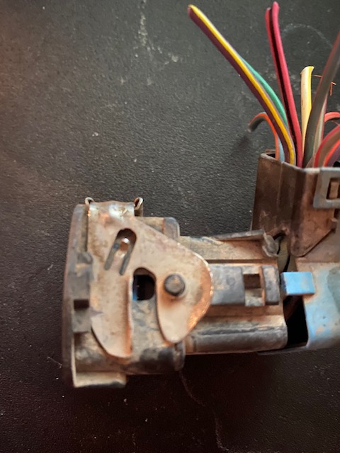

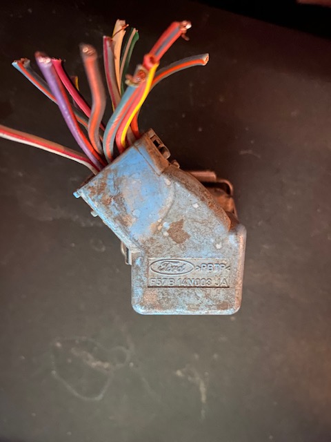

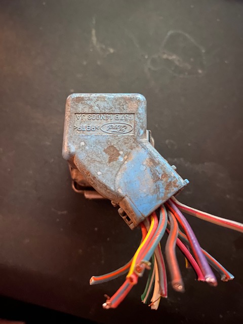

This is the plug that goes into the internal harness on my transmission. I cut this off of a junkyard transmission to look at the plug before I attempt to disconnect mine. As you can see, the plastic broke off on the top part....this plug was a B to disconnect, it has metal retainer around it. Is it possible that Im losing connection if I dont have dialectric grease? Should I use dialectric ?

Yes you should use dielectric grease, its suppose to be a watertight connection but dielectric never hurts. If the one on your transmission is loose I suspect the metal clip is broke, bent, or not on properly. That thing locks it down pretty tight as I'm sure you found out when removing that one at the junkyard.
