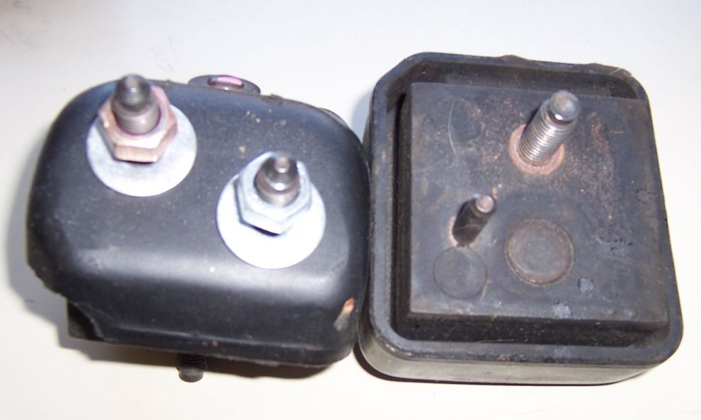

With the Explorer mounts, no difference at all if 4x2 or 4x4. both built on the same chassis. Had a new set for sale in the classified but no takers. Original Ford. Box they came in and a Google on what they fit. One problem is that the 4.0's couold be either OHV or SOHC, mounts are different. OHV takes 3L2Z-6038-BB and SOHC takes YL5Z-6038-CC. If you are making your own plates, won't make any difference.
Dave
OHV mounts uses
http://i216.photobucket.com/albums/...0-7544-4b02-af0a-cb291069a0f5_zpse15735d5.jpg
OHV mounts, SOHC mounts have the bolts that go into the plate aligned, not staggered
