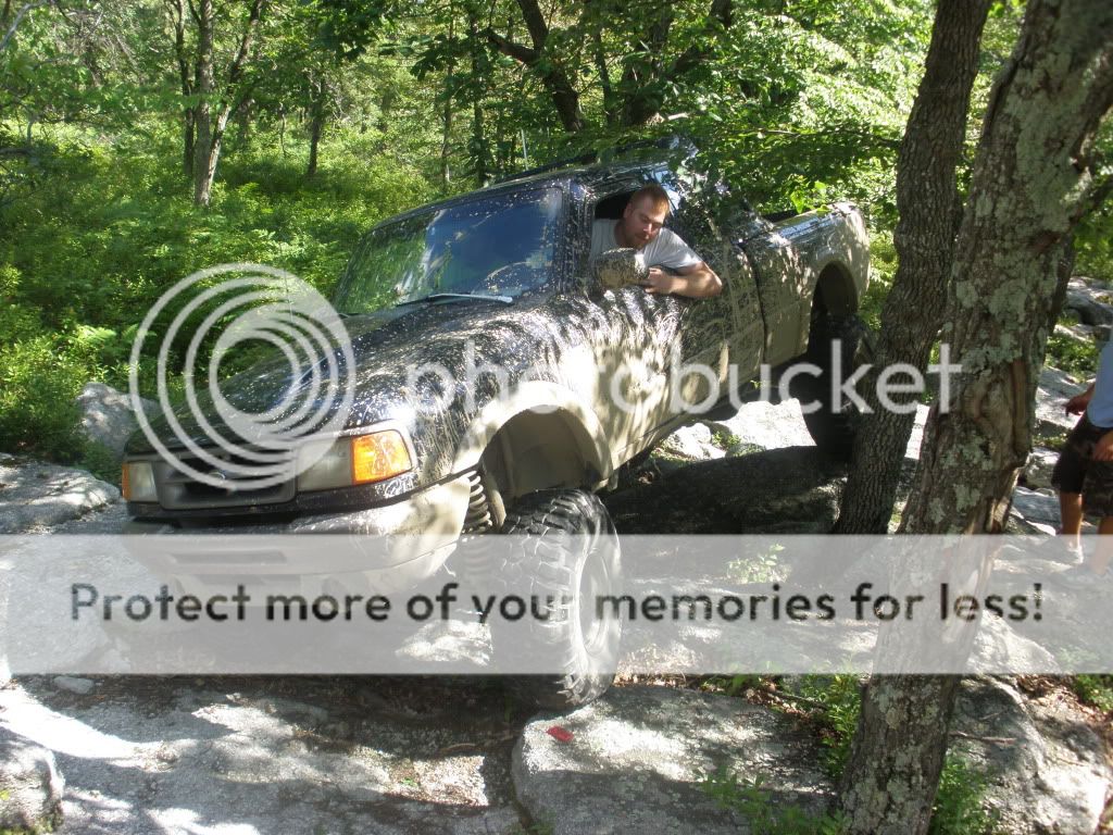

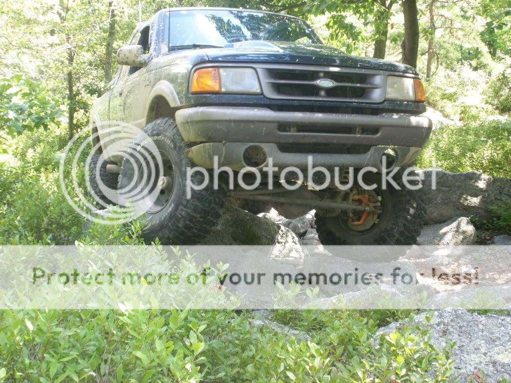

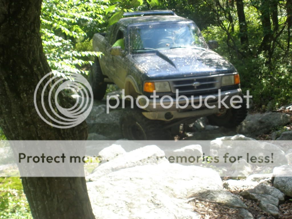

1996 ranger hp dana44 exp 8.8
well tested ox covers. and yup cut down hp 44 if i di it again would of used low pinion the high pinion is not needed with 3.5in springs

I would still use the HP diff as it is stronger and running on the 'proper' side if the gears.

i would cut the fender but i drive the truck on the road alot and cops are a pain around here with tires sticking out. was thinkin about the 2flair 2 bulge so they wont stick out much more than stock.
huh, they look just like riddlers, good brands none the less
