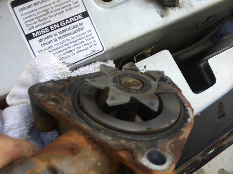

Ok here is the deal. I bought this truck and after driving down the HWY 40 miles or so it started to get hot. So I immediately changed out the T-stat and Radiator cap and that helped a little. But it started getting hot again so I decided to change out the water pump and it did need it.
Now the truck isn't getting as super hot but it is hotter then it should be. It is also building quite a bit of pressure both on the top hose and the bottom hose. So i removed the T-stat again to make sure it was not causing the issue. So now with the T-stat removed the truck is not really getting hot but is still building pressure.

Given the pump vane condition, I think the system was severly neglected. It may have a lot of sludge, plugged tubes, a clogged heater core, and more, so a good flush seems in order. The Prestone Tees seem to do a decent job and are relatively cheap. I'd go that route first, put back together, and see what happens, using tap water. If it works OK, then drain that out, and add un-dilute coolant to 1/2 of the capacity, and fill the remainder with water. If your house water is hard, get some filtered or purfied water in a jug and use that.

If it had rusty water in it chances are the aluminum tubes in the radiator are plugged, and some of them possibly plugged by the fins from the water pump... I've torn apart radiators that seemed to flow OK just with a garden hose but the engines overheated and the aluminum oxidation in the tubes was crazy and you could only see through like 3 of the tubes... replaced the radiator and it fixed the problem... I just looked for your year it's as low as $80 plus shipping at rockauto.com

I wanted to give an update on this. After a new water pump, Cap, Thermostat and a Radiator it seems to be repaired. Stays around halfway at the gauge and if it is really hot pout side it will go up a little and then back down as if the Thermostat is opening and closing. But seems to be fine with out getting up to the H at all
