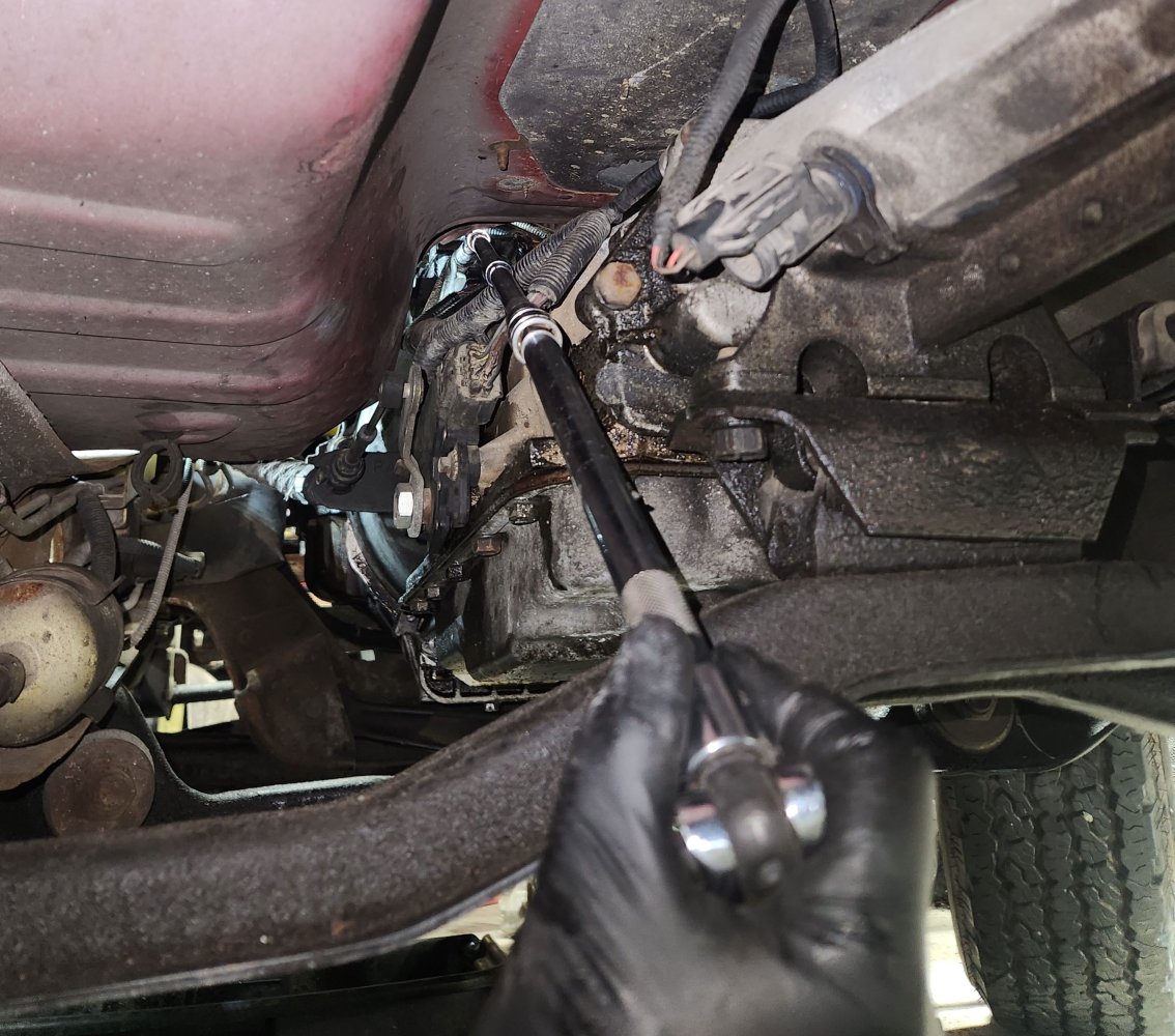

For anyone else that might find this thread on google, I have a process that works with minimal frustration as long as you have a bunch of extensions and a swivel adapter. It goes like this: put the socket on the swivel and add about 2.5-3ft of extensions. Then, from under the truck, just behind the transmission cross member, you should be able to see one of the top two bolts. You have to move to the other side of the transmission to see the other. Feed the socket and extensions over the cross member and up to the bolt. Spin the setup until the swivel straightens out enough that you can get the socket on the bolt. Attach your socket wrench and remove the bolt.
Looks like this:
1996 2.3 top transmission bolts
Then just move to the other side and repeat the process. It sounds complex, but it's really not. The hardest part is getting the swivel to cooperate while you're getting the socket on the bolt.
Easiest with a helper...
