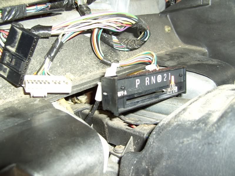

Thought I would add some pictures to help out owners of automatics.
Here Is the shifter cable attached to the pointer module,after it has been removed from the cluster.Note that the white plastic end of the cable should clip into the bottom of the pointer module.Mine came out during removal.

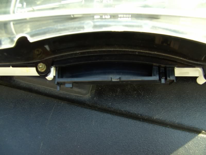

Here is the bottom of the cluster where the module clips into.
1995-current gage cluster removal (pic intensive)
Here is the module partially entered into the cluster,Note that the one in the picture is from a manual trans truck.So you can use a cluster from a manual Ranger.You just pop out the manual one and pop in your auto one attached to the shifter cable.You can see in this picture the two little plastic clips that must be pushed in to remove the module.
