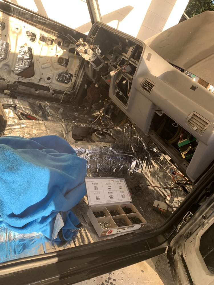

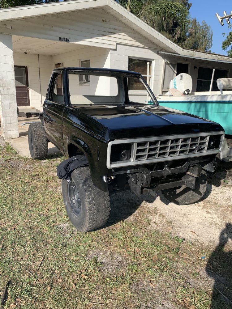

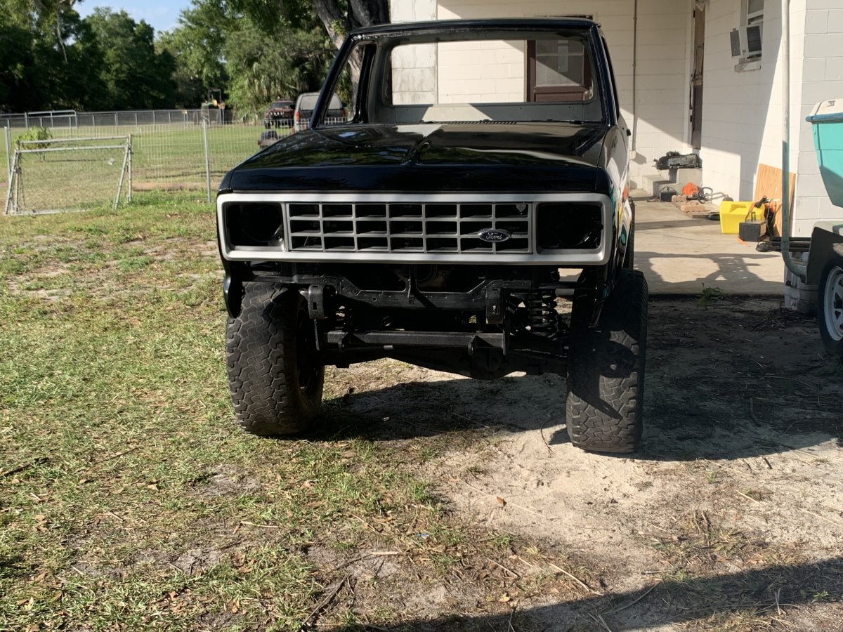

1994 Ford Explorer dash in 1988 ranger
Looking awesome!!!

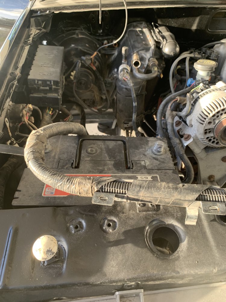

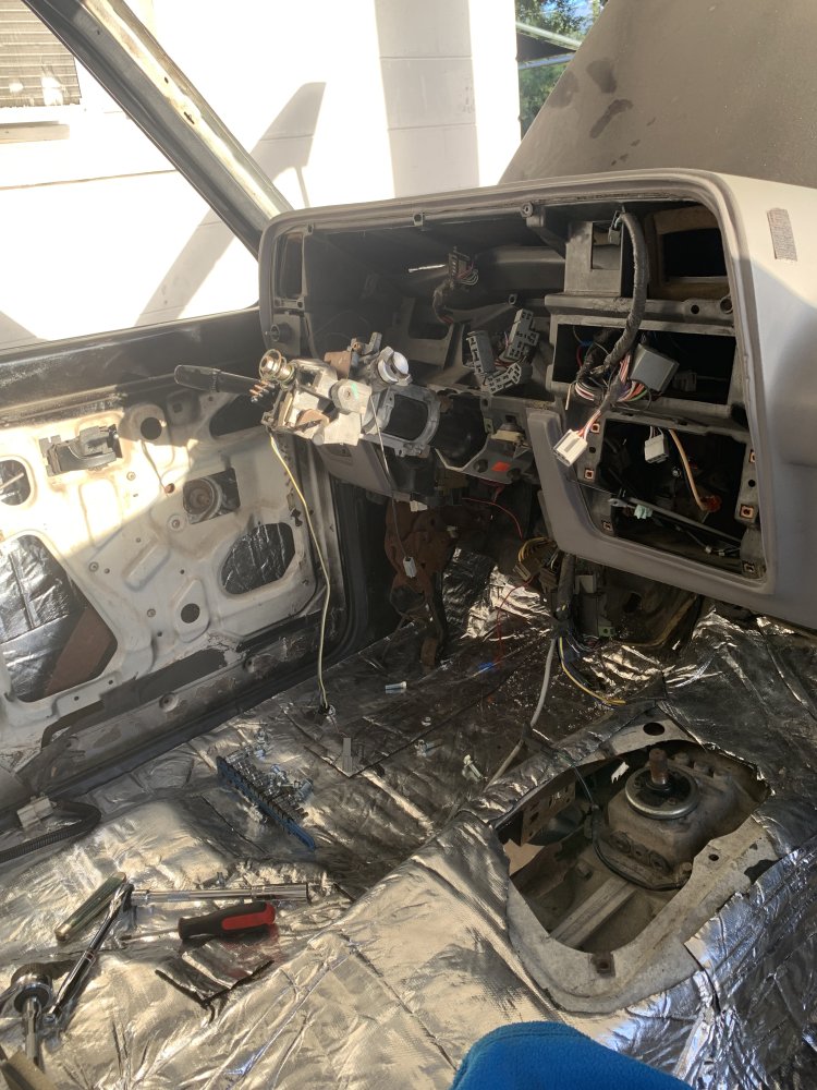

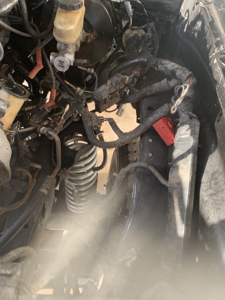

Putting the new wiring in from the 94 Ford explore to the 88 ranger and I’m wondering do I need to take the abs brake stuff out of the explorer as well to put in the ranger or can I bypass all that ?
Nobody knows anything about that lol
You can bypass all that junk. Brake light might come on or it might not or the ABS light might come on. I would just pull the bulb.......................

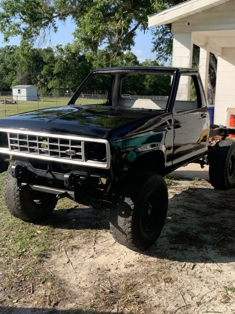

Making some progress but holy shit the wiring on this thing is crazy but I think I’m gonna make it
