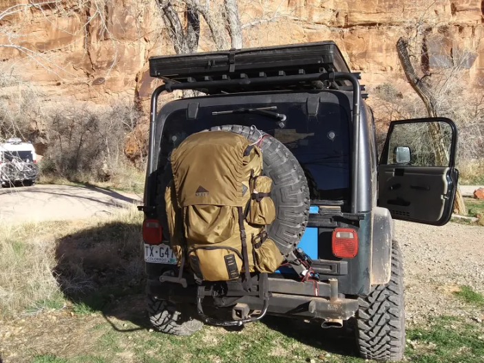

Speaking of backpacking with a vehicle... Been there, done that. This is how a friend of mine's LJ hauled my stuff back from Moab to Denver a couple of years ago.
