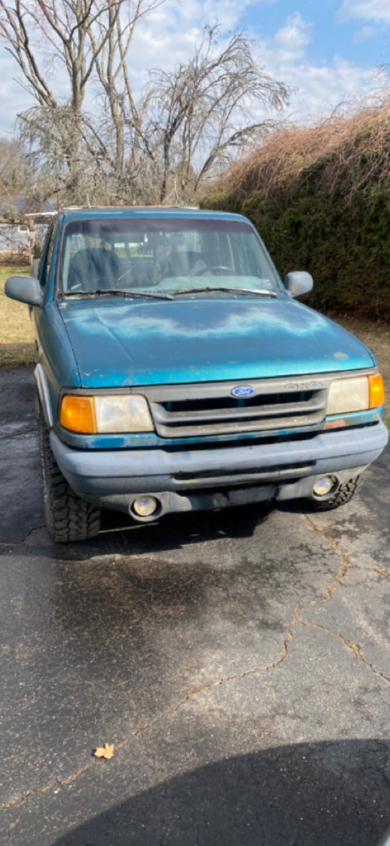

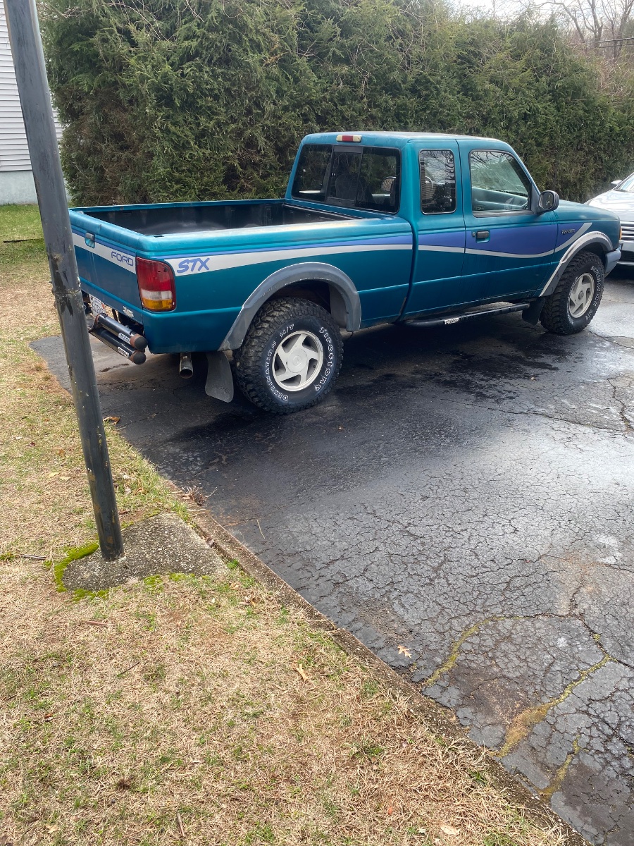

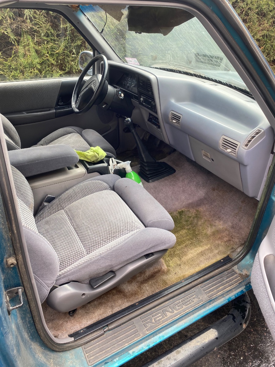

I just picked up this 93 stx that’s been sitting for like 20 years. Trying to get it back on the road, after my 1987 ranger was totaled back in December. It’s definitely a project, but it’s got some decent parts on it and the frame is clean for New England.
Have to clean the gas tank out, and swap out fuel pump and filter. What’s the best way to clean a plastic tank?
I have to figure out where it’s leaking water into the cab, I suspect it’s the windshield and 3rd brake light.

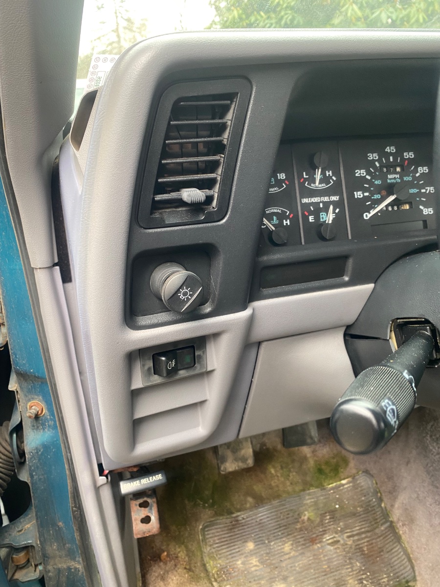

Nice! I see that you have fogs on it - I'm puttinjg them on my 94 and am curious where and what the fog lamp switch looks like and where it is mounted.
I get that your busy, but if you have time and when you get a chance, please post a pic of that switch and its location 🙏 pleeeze

I think this had factory fog lamps, because the switch looks factory. Although the lights are aftermarket PIAA units. I’ll take a picture for you tomorrow, I got the truck all covered up for the rain coming overnight.

It’s the switch under the headlight switch, looks factory to me

I apologize for hijacking the post, but thank you very much for your response. As an FYI, when I pulled the panel on my 94, the mounting position for the switch was in the bottom-most indent - two down from where yours is. All the guts and wiring was there, just mounted two positions lower. File this under stuff that doesn't matter:rolleyes:
