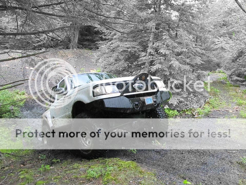

Well went on some trails today. Truck did amazing. I really need to fine tune the front suspension now tho. (i.e. extended radius arms/longer shock towers). I now completely understand why everybody raves about having a locker. It is literally night and day. I didnt spin a tire the whole trip.
Love a white truck with mud all over it!!! Truck is looking really good
