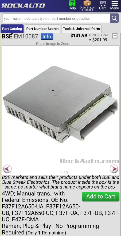

Rock Auto has them available but only for a manual shift. Will that work?

Will this Work Ron? It's for a Manual Trans. though.
Not correctly; solenoids on the auto trans are controlled by the computer.
You wouldn't have Overdrive and torque converter wouldn't lock up as fast so MPG drops
