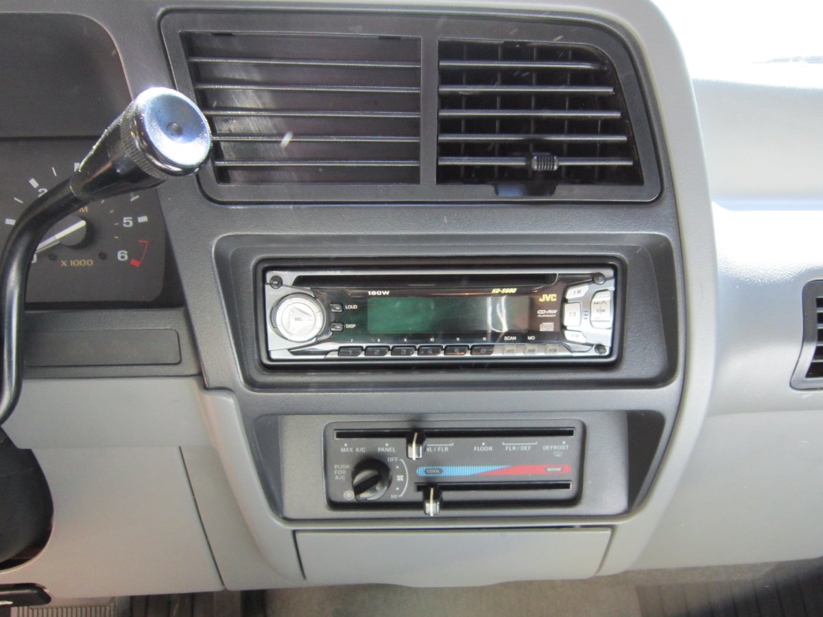

I'm installing one now .Those plugs are correct . You should have a plug for the radio .Those will hook to them , which will have the same color. Then plug them into your harness . Those wires however will not match your factory colors . Mine is a 90 Ranger. The plug you show will work on a standard radio or one with the factory amp and power antenna. Hope this helps

RobbieD is correct. No kit required . Got mine finally in . However the opening in the dash was a tad to small. Took a fine flat file and opened it up . It was on the sides that was to small. File a little and check. Like I said it's not very much.
