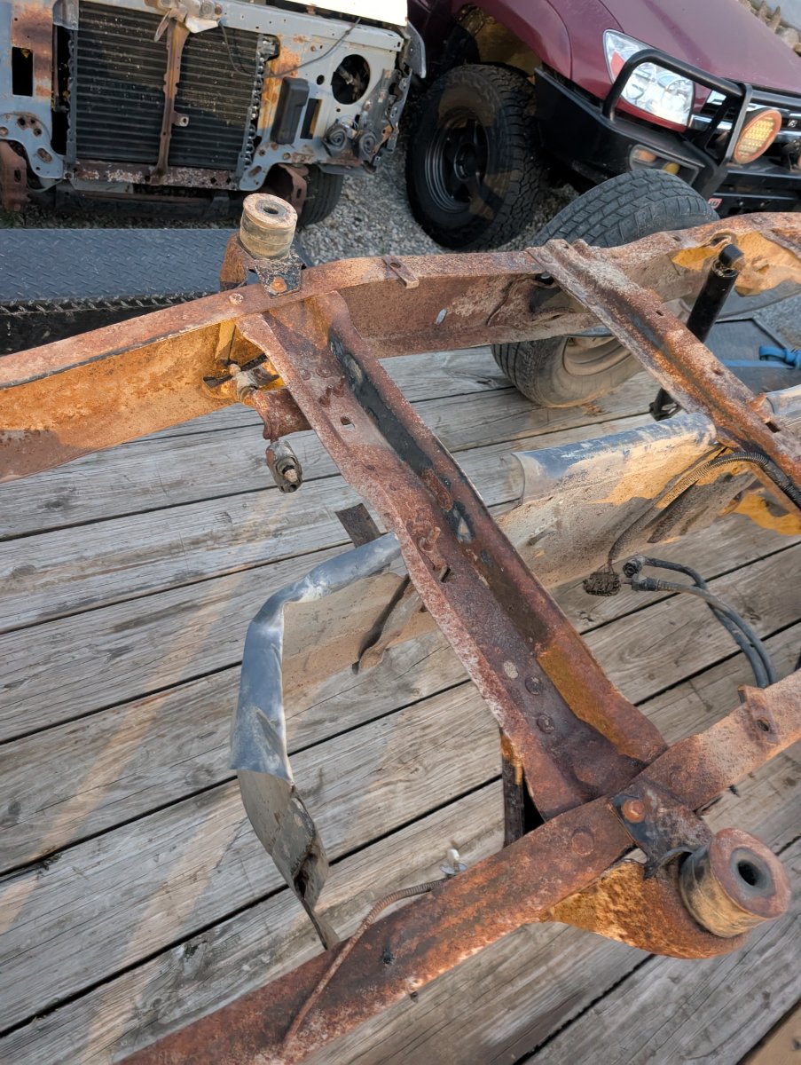

Well...I brought the trailer to work, so I'm grabbing the chassis regardless now. It comes with a rear axle, gutted cab, and wheels, so its worth snagging regardless.
Looks like the front tank crossmember is the same, but the rear tank crossmember is different where the rollover vent is located. Potentially still interchangeable (will update later this week hopefully)
Was also surprised to see beams with ball joints oriented the same as 93-97 trucks.
This is the first 89-92 Ranger (or part of one anyway) I have ever had (mostly because I just don't like the look lol)
