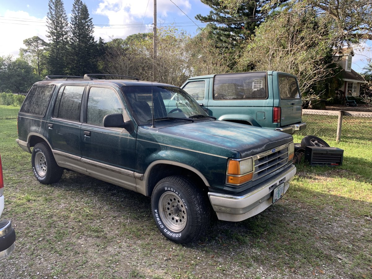

Finished my daily driver finally so time to build my 87 that's sitting on jack stands. The A4ld is toast so I've been looking for donors before deciding exactly what I'm going to do with motor/transmission swap. Got my hands on a 1992 explorer automatic 4x4 for super cheap. The 4.0 runs kinda shitty so i might pull it for a rebuild and do the 4.0 swap but I was wondering if I could go another route and just run my 2.9 to the ground then swap a ho 5.0 in the future. Would the a4ld in the explorer bolt up to my 2.9 no problem? The explorer is shift on the fly, is there wiring I can do to make it work for my 2.9? I would swap the 4.0 but id rather just use the tranny on my 2.9 for now and just focus on swapping the d35 and 8.8 and finish a little body work while i look for a 5.0 to build and c4 trans to go with it. I got the explorer mostly for the axles and just a parts truck. id rather swap a 5.0 and just use the transmission untill then if possible.
