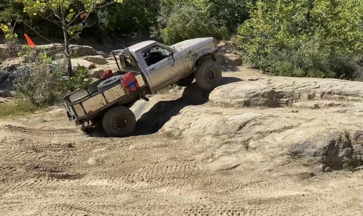

I am not trying to re-invent the wheel here and haven't found any solid answers through the web. What FMIC do people run in their first gen? Sure the '88 TC IC works, but I would like to go with a front mount and utilize the blow off valve I have on the shelf. While we are at it, I could use a rebuild kit for the IHI unless someone has a solid unit they would like to move on from. Lastly, for now, I am running a stock fuel pump from the Ranger. I won't need a 255 lph pump, but would like to wire in a 190 lph. Anyone have a part number? Is there a solution for a float that doesn't break when offroading? Replaced the whole unit and the float broke second day on the trails.
Excuse my ignorance as I am still fairly fresh to the offroad world as well as the 2.3 lima. Thanks!

I haven't pulled the pump out since its a PITA (pain in the ass) to get to but the guage constantly reads full. Guess the float/arm got stuck in the up position when i came down from a rock wall. All i know now is i have to refill every 150 miles hahah.
Gauge stuck on Full could be the newer style, 160 ohms Full, being disconnected, especially if needle is above Full, that's more likely than broken float
There is also an Anti-slosh module on the back of the instrument cluster, it can break and show either Empty or Full all the time
If you want to pull the cluster first, there is a Yellow/White stripe wire on the connector, that runs to the Sender in the gas tank, you can use an OHM meter to test it, if you rock the truck while testing the OHMs will go up and down as the float goes up and down when gas sloshes around, that would confirm no stuck float and that the sender is OK
The sender is also grounded on the frame rail and that can come loose or wire breaks, same symptom HIGH OHMS because no ground(that should be an Orange Wire at the tank connector)
