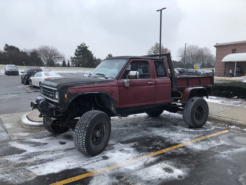

At this point I needed to address the lack of a bed. I have always wanted to do some tube work on an off road truck. I have done one cage in a 1989 3 series bmw and helped build one formula SAE car so this would be my 3rd try at this kind of work. I had a few design goals
• I wanted the bed to be similar in weight to the stock bed. I expected that the weight would be more but I didn’t want hundreds of pounds more.
• I wanted the bed to accept a 4ft wide sheet of plywood. I use my truck for house construction projects too.
• With the tailgate down I wanted to be about 8ft long.
• I wanted to be able to drag a tree down the side of the bed and not worry too much about dents
• I wanted bed sides to keep camping gear in.
• I wanted lots tie down points for ratchet straps
• I wanted the fuel fill to stay in the stock location ( I have had issues with filler necks on flat beds before not working well).
• I wanted a hoop behind the cab that could be tied into a front exo cage in case I ever go that route.
• Really just wanted an excuse to play with my welder and waste money.
I looked at just about every tube bed / flat bed ranger on this site and the internet and pulled inspiration from these two in particular.
At this point I designed the base of the bed in Solidedge to get an idea of the weight.
Once that was nailed down I ordered the material from alro steel. 20ft sticks and had it dropped off at my work.
Some guys might not like this but instead of steel decking or expensive aluminum I chose to run 1x6 yellow pine lumber to keep the weight down. If this truck was going to sit outside all the time I would have spent the money on aluminum. However it lives in my garage 98% of the year. The decking is actually wood from a school gym seating that they were getting rid of. So if this wood ever wears out I have lots more to replace it with. After a few years though it looks pretty new yet and has performed well. I will let the pictures speak for the fabrication process. The main tubes are 2.5 box tube with 0.080 wall to keep weight low. The cross bars are 1.5 box tube 0.190 wall. This keeps the 1 inch wood deck flush to the top of the sides. I used 1.5 inch angle iron at the front and back edges. The sides are 1.5 inch erw tube with 0.125 wall. If I recall the bed is about 100lbs more than a stock long bed, but don’t hold me to that exact number its been a few years. If you wanted to copy but planned to spend more time on your side than the wheels I would bump up to DOM tube and a bit thicker on the 2.5 inch box. Also a big thank you to my friend who let me borrow his mandrel tubing bender for the main hoop and bed sides.

on the first bit where you were contemplating spring under or over vs steering...1st thought was wj knuckle.....glad i kept reading and seen you found it....there are aftermarket setups that are nicer yet..
the bed is neat. sometimes mine is sheet wood and plank....sometimes steel depending on what i am doing....i made a drop in from synthetic decking and it was too slick and thick. the sheet warps though....but i beat the hell out of it. if i trash it too much from oil/chemicals...just burn it and replace.
i can extend the side height when i have too, so i split the difference and raised the deck height in favor of up travel and under bed stowage and built fenders...
the way your deck turned out is really nice. never stained/sealed mine....really like it!

The WJ swap is a great upgrade with the bigger tires. I can lock up all 4 wheels at any speed even with the bed full of junk. The only reason i see moving away from this set up will be if i decided to run a D60 at some point. But for my driving style i don't see that happening in the next few years.
the bed is my favorite part of the truck, i am glad you like it. I get alot of weird looks driving around town haha. I have been impressed with how the wood has held up. I could see me choosing to raise the bed or add wheel wells in favor of more travel. Right now my shocks limit the travel to about 8" total up/down.

my bed works well for me and reconfigurable...its too high for my age and physical condition these days, but isnt any different then a modern 4x4 1/2 ton...
I hear ya, I think the days of Solid axle small trucks in the US are over. Too bad we don't get some of the cool stuff the Australians get. I will have to figure out how to look up your build thread. I see in your signature you found a way to get a full size diesel in yours. Sounds like my kinda project
