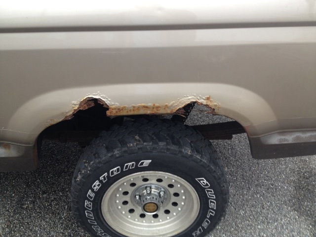

Front drivers side coil spring top mount had bad rust.
Obvious rust on bed and drivers side cab corner.

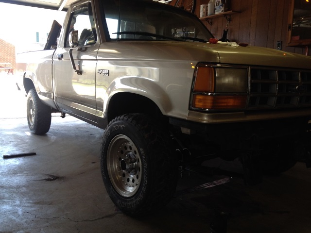

As a teaser this is the current specification list as of spring 2018
SAS dana 30 front 4:88
jeep wj knuckle and brake swap
front leaf spring, from 1995 explorer
8.8 31 spline rear 4:88 traclock
chevy 63 rear springs
285/75/16 BFG km2
chevy 1 ton steering
afco shocks
1988 ford thunderbird 2.3 turbo
ron fransis engine harness
AN -6 fuel system
tube chassis bed

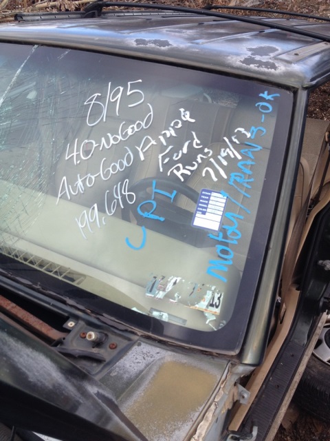

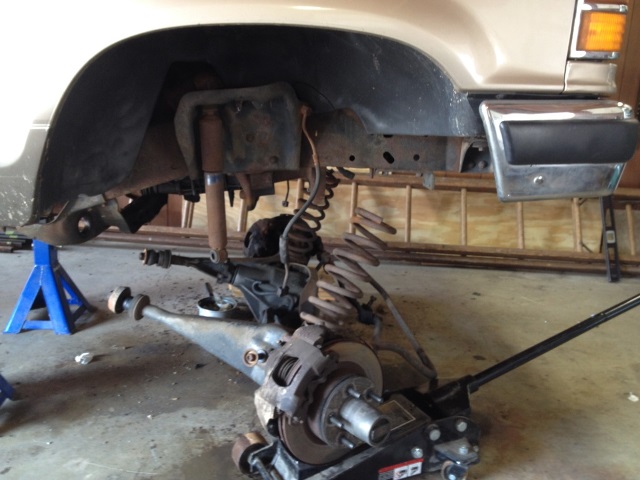

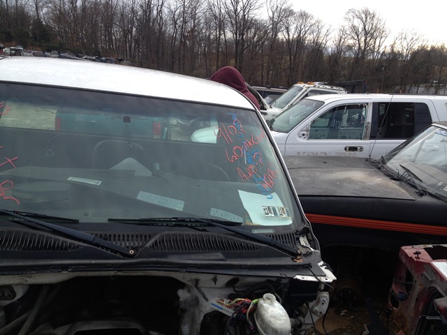

After researching all the options and considering my budget at the time I decided to look for the following parts at local salvage yards. Rear chevy 63” springs for the rear suspension. A dana 30 high pinion front axle out of a xj, or yj jeep. I wanted one without the vacuum disconnect and preferably one with stock 4:10 axle ratio. A few weekends later and I was able to source the springs from a 2002 chevy 2500 hd that had front end damage. The truck was clean and I was able to grab the u bolts and axle plate as well. The springs had good bushings still and only set me back $40 for the pair.
1991 SAS build
1991 SAS build
I was unable to find any dana 30 HP in the 4:10 ratio so I settled on one from a 1995 xj that had 3:73s. The axle housing with brakes came in at $100.

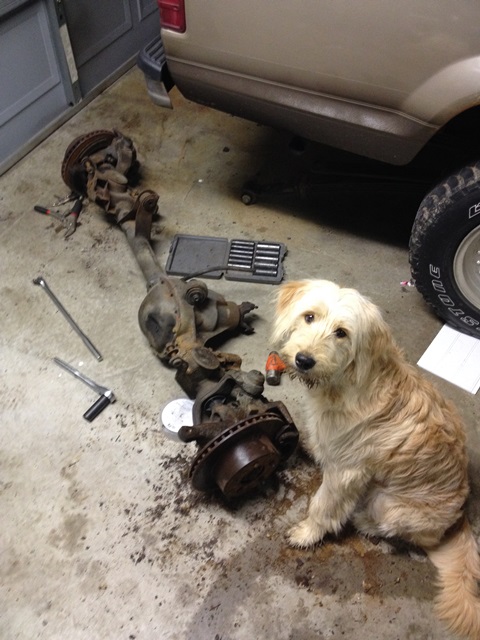

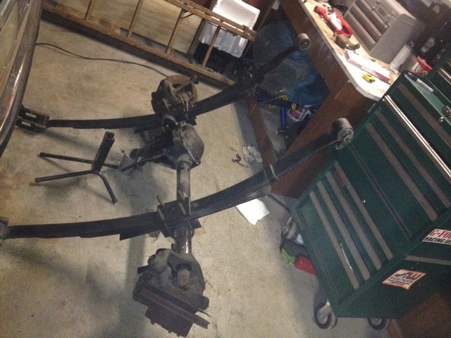

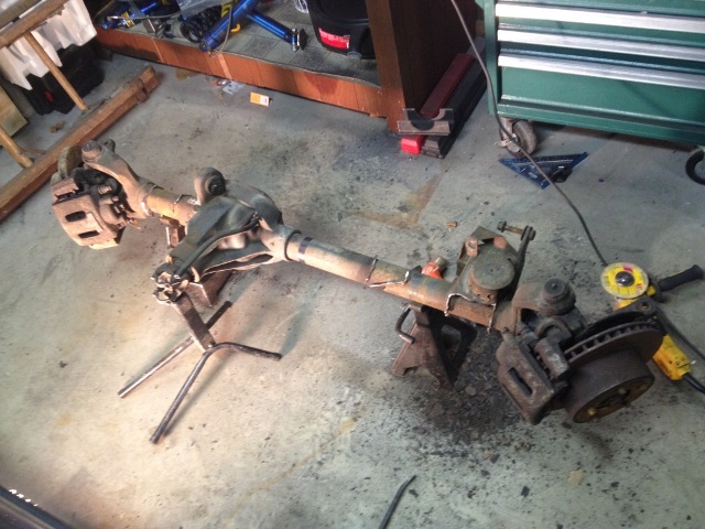

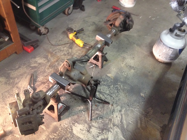

I spent some time and stripped the dana 30 axle down in prep to go under the ranger. I also cleaned and painted the Chevy 63s.

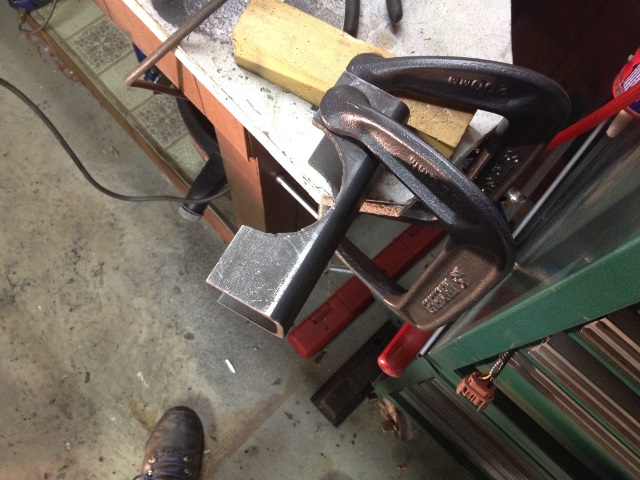

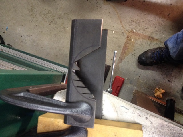

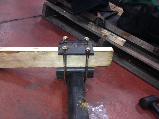

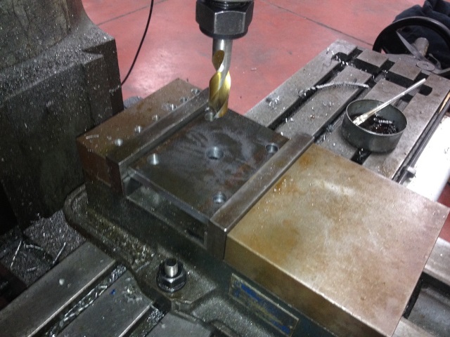

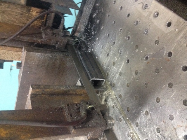

I went ahead and ordered some U bolts for the front dana 30 and fabricated the top plates. At the time I also used some heavy wall box tubing and fabricated some spring pads. Later in the build I switch these out for a nice set of anti wrap units. I have access to lots of various steel sizes at my job so I was able to buy material drops for a reasonable price.
1991 SAS build
1991 SAS build
1991 SAS build
1991 SAS build
1991 SAS build

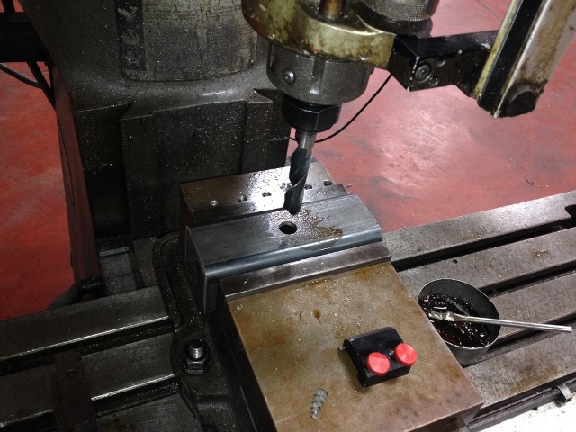

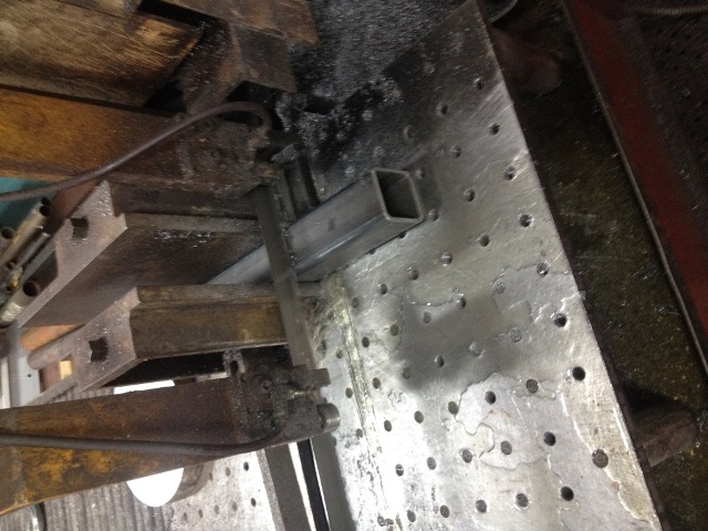

The top plats were made from 5/8 thick steel if I recall correctly . I made sure to round the contacting edge to avoid stress concentrations. I used a Bridgeport mill to put the holes in but you could do the same if you are careful with a drill and your measurements.

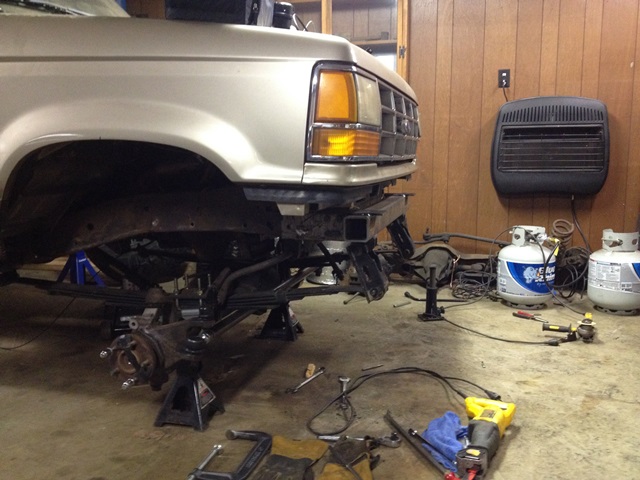

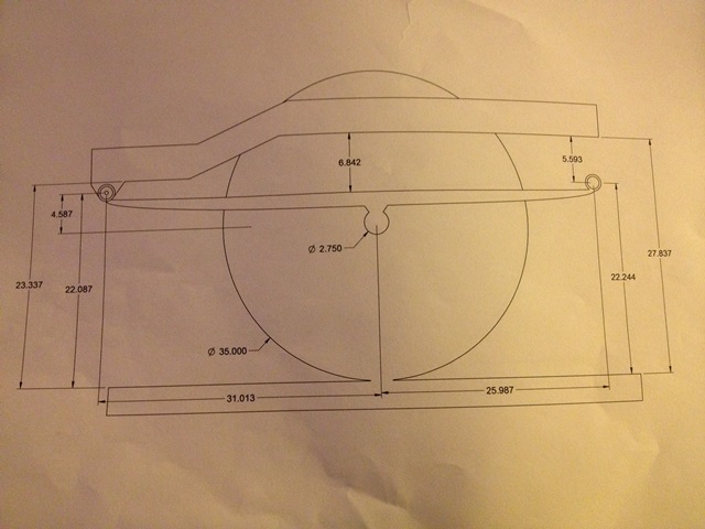

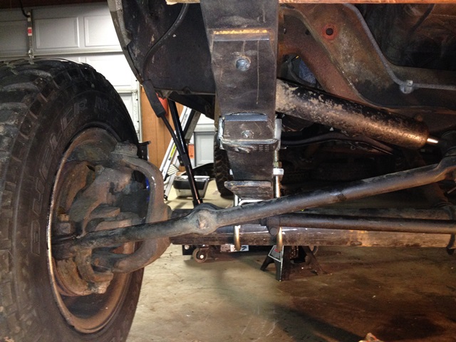

Then I spent a lot of time looking at axle under versus axle over for the leaf position.
1991 SAS build
first time the leafs were on the d30
I wanted to keep the truck height as low as possible. I was well aware of the limits that a leaf spring front and I wanted to limit axle wrap so axle over leaf was my first choice. I found the dana 30 hp will fit under ranger and if centered correctly can maintain an almost stock ride height. The steering linkage would also be very simple to take from the xj as it would all clear above the leafs. However the upward movement of the axle is very limited. I don’t have the exact number but I would have only had maybe 3 inches of upward movement until the differential housing would contact the engine cross member.
1991 SAS build
clearance from diff to engine cross member in axle under config
I have seen trail rigs work well with small up travel and all droop. This set up also is not great for ground clearance with leafs and bolts hanging low. The trails in PA I run have lots of rocks and ground clearance is at a premium since I only plan to run 33 inch tires.

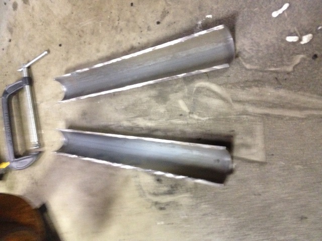

I also used some heavy wall pipe material to make a half round skid plate for the dana 30 axle tubes. i have seen d30s fail after denting a tube on rocks. I wanted to try this a cheap insurance from rock damage. I sized the u bolts to fit the od of the skik material. These were later welded on as well.

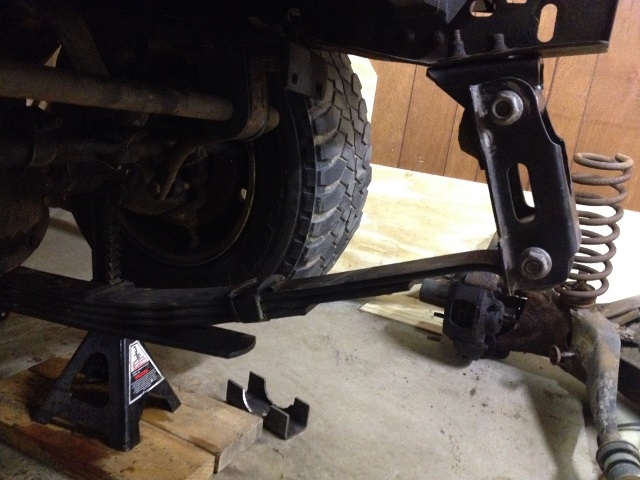

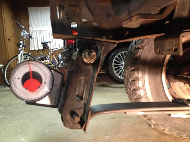

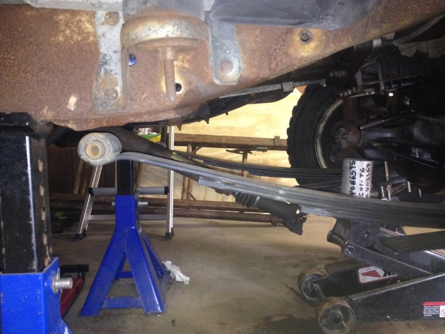

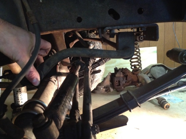

To overcome the up travel limitations I moved towards the axle under leaf configuration. This greatly complicates the steering. The leaf spring ends up directly where the steering linkage wants to sit with the stock xj knuckles. A lot of guys end up running S shaped drag links to overcome this however the amount of S shape required seemed excessive. More on this later. The axle under configuration fixes the ground clearance issue and seemed to put the truck at a nice ride height.
1991 SAS build
1991 SAS build
1991 SAS build
1991 SAS build

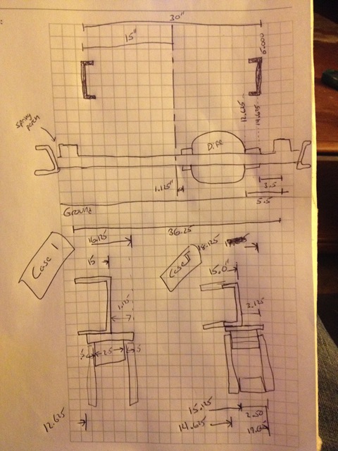

The next big questions were width of the leaf spring spacing. The obvious answer would be to use the standard leaf spacing used on YJ front dana 30s or at least a common spacing used on other bigger axles in case I wanted to upgrade in the future. Turns out this is really not easy to pull off on a ranger. The front frame spacing on TTB trucks is narrower than that of a YJ jeep. And the spacing used on say a ford dana 60 front leaf is much too wide to allow any turning radius on a dana 30 hp from an xj or yj. So I ended up compromising on a width that would allow full turning with a 33” tire and matched well with the ranger frame. In the future if I upgrade the front axle to run larger than 33” tires I will likely install a 3 link and coil spring at the same time. If someone wants to know the spacing I can measure.
1991 SAS build

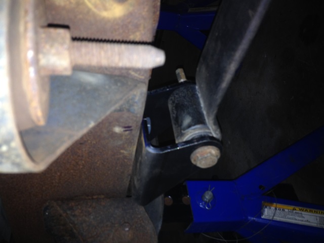

The last questions were where to run the shackle. I much prefer rear shackle front leafs due to keeping the front leaf in tension under hard front impacts while wheeling. It’s a lot harder to buckle (fold up) a rear shackle leaf set up. I looked at a lot of ways to do this on a ranger with my spring spacing. Ford F250s from the early 2000s do it nice with the shackle going around the frame.
1991 SAS build
F250 rear shackle with front leafs and d60
This could also be done on a ranger but would require that the shackle be pretty wide. It would also require an accurate hole be drilled in the frame and a DOM bushing sleeve be welded in. The accuracy of this hole and bushing would need to be spot on to avoid having the axle sit strange in the truck. The big problem I found with trying to make this work on the front of the ranger frame was the rake angle that you would end up with a rear shackle. The front of the leaf ends up high in the vehicle and the rear ends up extra low. To fix this you have to lower the front point even more subsequently raising the ride height even more. You will often see this angle on front leaf setups that are done at home. I don’t think the on road manner with this angle would be good but I could be wrong. My final decision was to run the shackle at the front of the leaf to achieve the right leaf positioning in the truck and keep ride height as low as possible. I know the type of off road driving I will be doing and my own tolerance for beating up trucks. So this will work well for me but I can’t say if you are the type of person who likes to get into the big rocks and ledges this would be a good solution. You would likely want to at least carry a spare main leaf for when you flip the shackle on rock and buckle the leaf. Double wrap military style leafs would help with this too. In defense of this solution there are many iconic 4x4s that run this set up including wagoneers, jeep yj, and classis land cruisers.

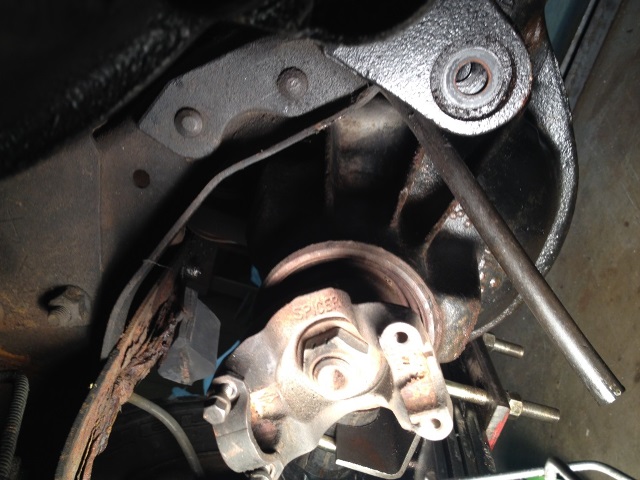

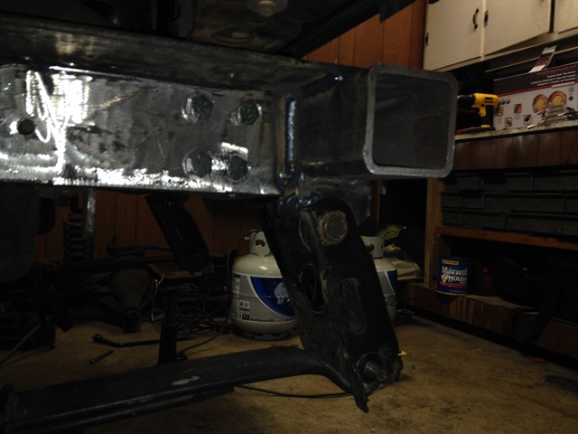

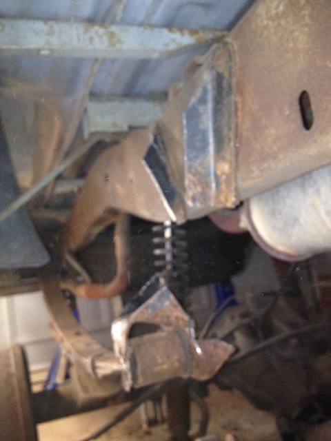

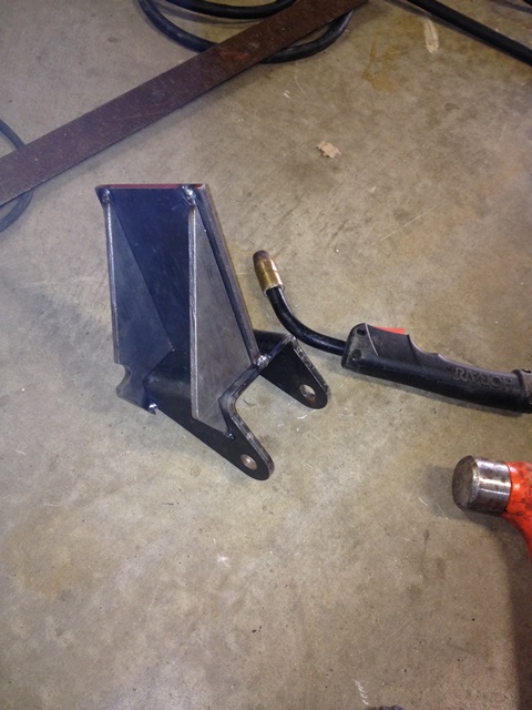

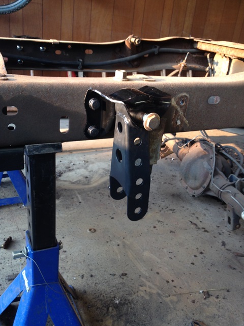

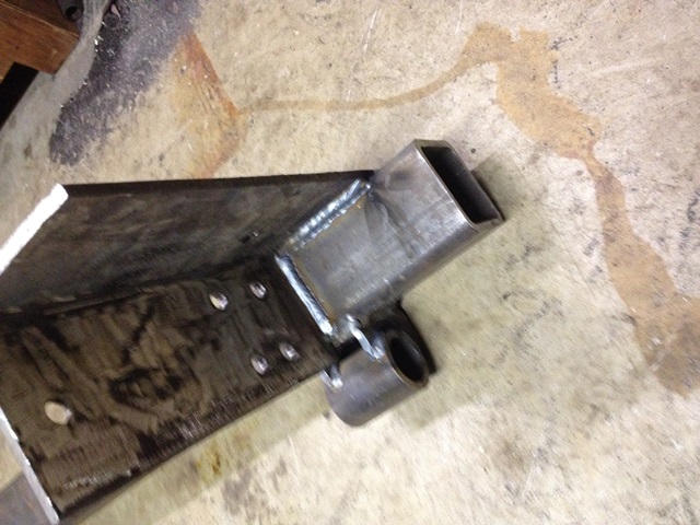

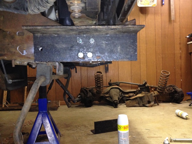

At this point I needed to start thinking about the leaf spring mounts for the front. I got a set of leaf spring mounts from barns 4x4 as a starting point and fabricated the required plates and braces to achieve the correct leaf spring spacing. My goal for the front end was to have everything bolt to the frame. This would allow me to remove and change the design if I didn’t like how the final product drove.

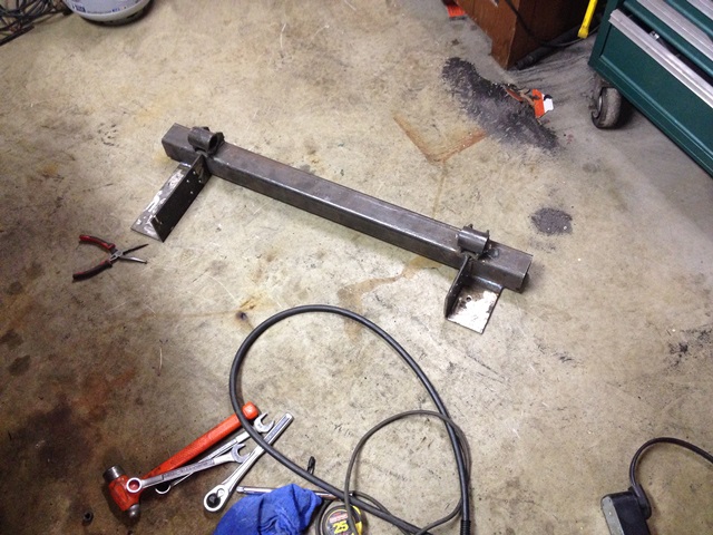

With the rear mounting point installed I was able to look at shackle length and front cross member design. I ended up removing the two front body mounts and created a cross member that integrated the cab mounts, leaf mounts and would provide a solid foundation for a winch mount later on. The front cross member required the frame horns be trimmed down and I attached the factory brackets to mount the stock bumper for now. The main member is 3x3 0.250 wall tubing and the angle plates was about 3x3 0.190 wall. The front leaf shackle is also from barns. I extended length of the bracket and added more bolts to better react the bending moment introduced from the shackle load. The shackle length ended up being same as a rear shackle from a ford explorer. I am still running the stock shackle. I was thinking that when I broke it I would make heavy ones but they have held up well so far.

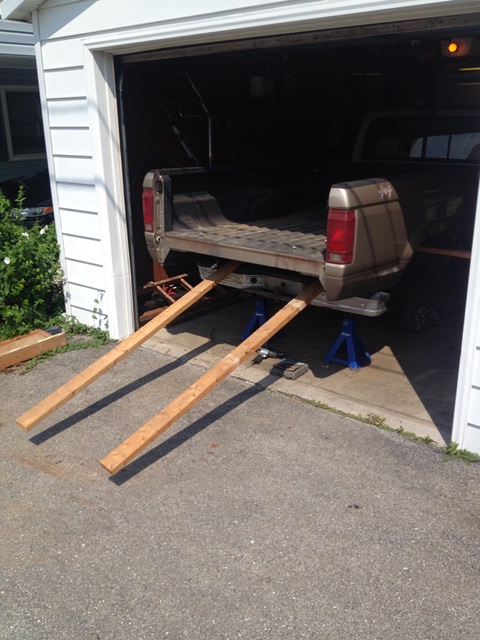

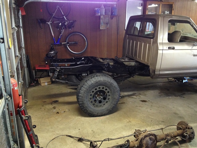

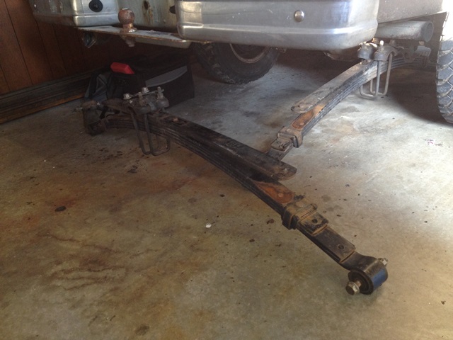

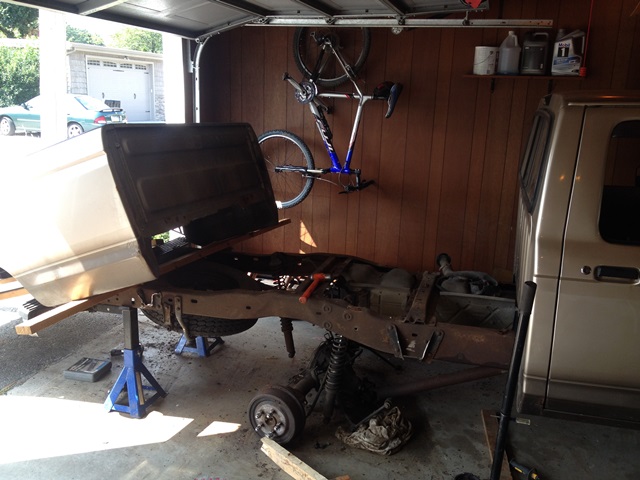

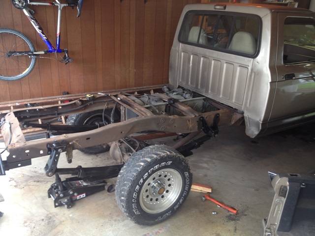

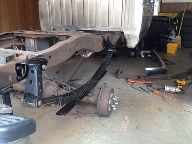

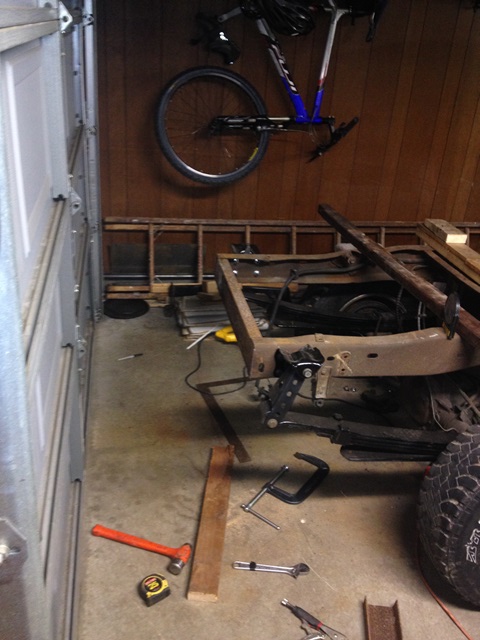

With the front axle under the truck a moved my attention to the rear suspension. I ordered all new leaf spring mounts from advanced auto parts. I removed the bed to get better access to the frame.
1991 SAS build
1991 SAS build
1991 SAS build
1991 SAS build

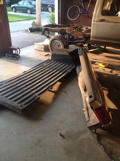

At this point I decided the bed was a total loss from rust damage and I cut it up to move to the junk yard easier. More on the bed solution later.
1991 SAS build

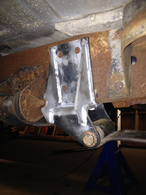

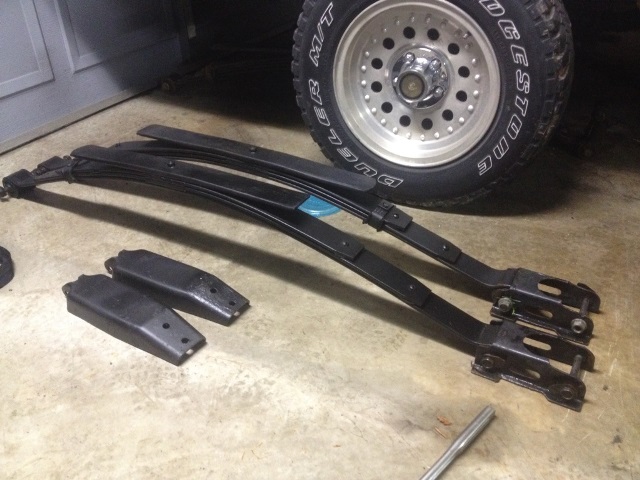

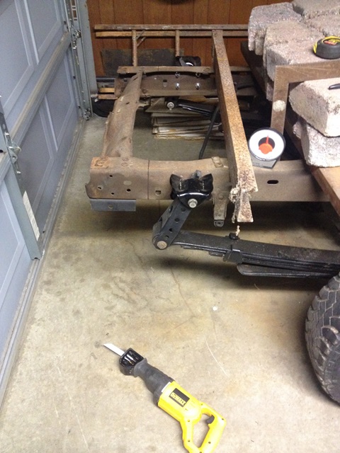

I performed the well documented chevy 63 inch spring swap using chevy lowering shacks from advanced auto at the rear. I went with the shackle in compression since I’m not looking to do any long travel desert pre running. This lifted the rear of the truck but I still ended up needing a 1.5 inch lift block later in the project to get the truck level.
1991 SAS build
1991 SAS build
1991 SAS build

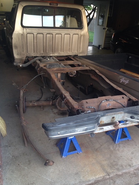

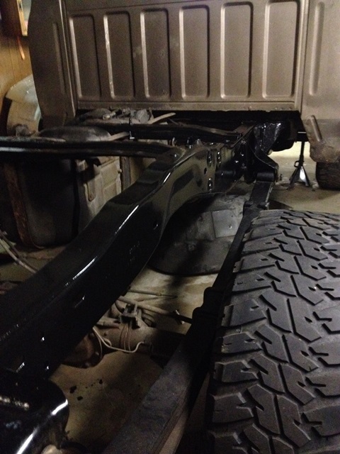

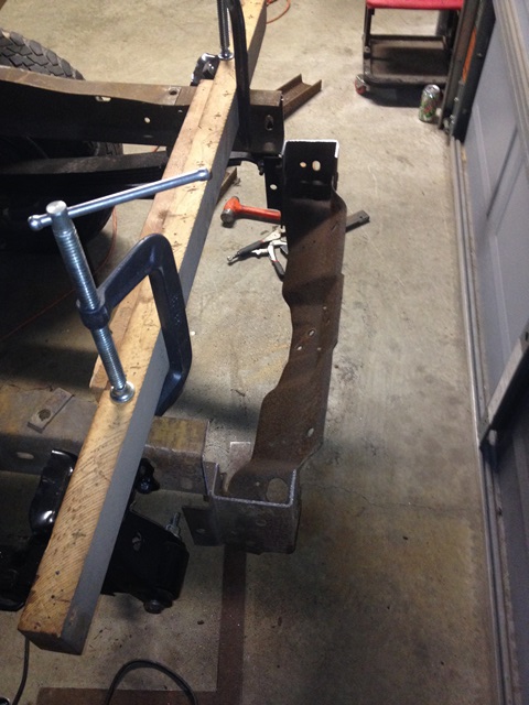

I used this time to clean up the frame and prep for paint

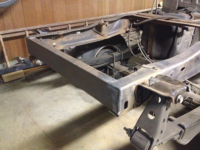

I also wanted to improve rear break over angle so I removed a few inches from the rear of the frame and installed a new rear cross member. In total if you count the bumper length I removed 17”. This was about the maximum amount I could remove and still have room for the shackle brackets.

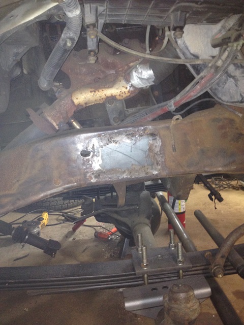

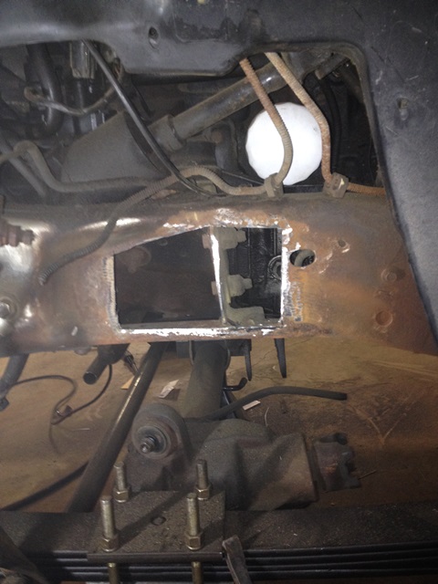

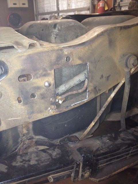

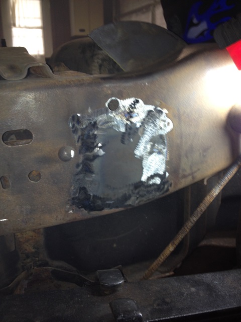

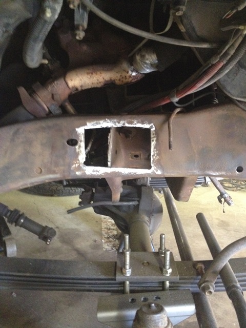

I inspected the frame everywhere and identified any areas where rust had compromised the thickness. There were three areas that I cut out to full thickness metal and welded back in with stock thickness material. In all cases these were areas where brackets had been riveted on.
1991 SAS build
1991 SAS build
1991 SAS build
1991 SAS build
1991 SAS build
1991 SAS build
I know the size of the holes cut look intimidating but I worked on the side of cutting back until i was sure i was at full frame thickness metal. The new plate were burned in nice and i have had no issues since.
With the frame in good shape I put down some POR 15 paint to keep things from rusting in the future.
