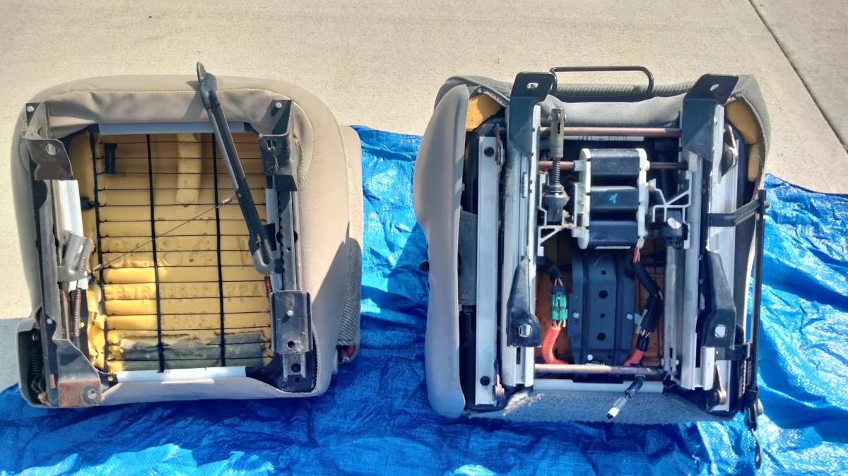

I just put 1995 Explorer Eddie Bauer electric (high back bucket) in a 2nd gen like yours (88-92) and if you are 6'7" I ***strongly*** suggest a NO GO on saving the power function it adds too much height. I am 5'7" / 5'8" on a good day, and I am going to be reworking the brackets if I can (I just finished the first round of fab 2 days ago, and got em installed). Now the Explorer seats are great and if a guy can save the electric lumbar or find a manual lumbar while using the ranger tracks, the ranger tracks preserve a much lower stance. As soon as the tylenol kicks in I am heading out to start work in it now, if you want pix I can certainly oblige.

Passenger seats side by side, 1990 Ranger stock left, 1995 Explorer (EB) right. the most common swap is to discard all the electrics and use the ranger tracks on the donor seats.

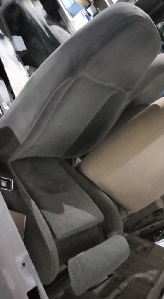

that's a good point. my junkyard is currently rich in 02-06 explorers. I will probably head out this week and can pull a seat out to take a look.

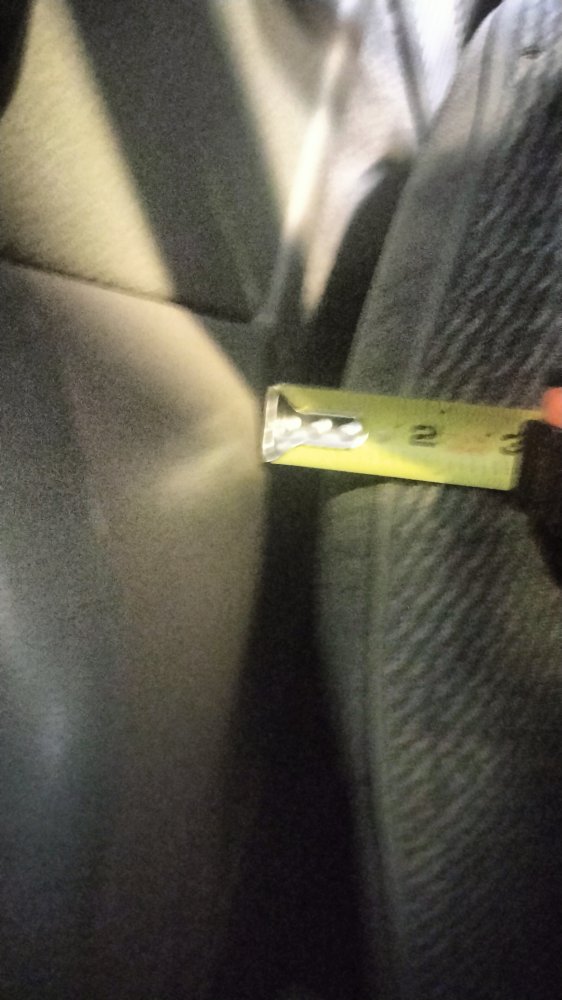

I can verify this, I can fit my hand between the seat and door with the door closed to run the main electric switches, but I can NOT move my hand forward to get to the lumbar switch and bolster switch because the side support extends so close to the door that getting my hand in there is a no go. (1995 Explorer Eddie Bauer seats in a 1990) I mounted the Explorer seats center aligned on the lower HALF the stock 60/40 Ranger tracks salvaging the electrics and the upper HALF of the explorer tracks.... that bit of fab added some height. In the area of the lumbar switches the clearance is about an inch.
Sorry it's blurry and dark, the garage is not well lit.
My yard is full of 02+ explorers and has several 3rd gen rangers, unfortunately the only two 2nd gens are extend cabs... and I am looking for interior trim parts for my '90.
