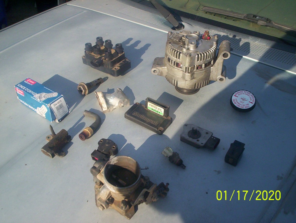

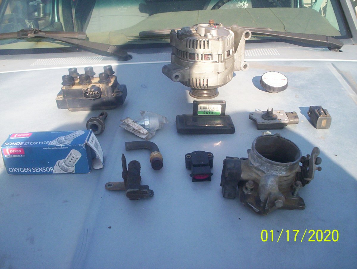

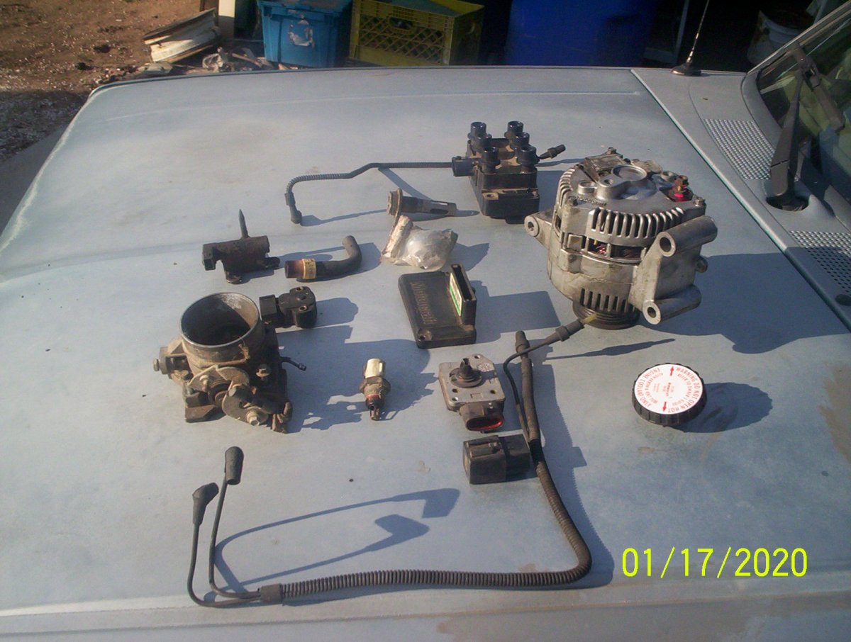

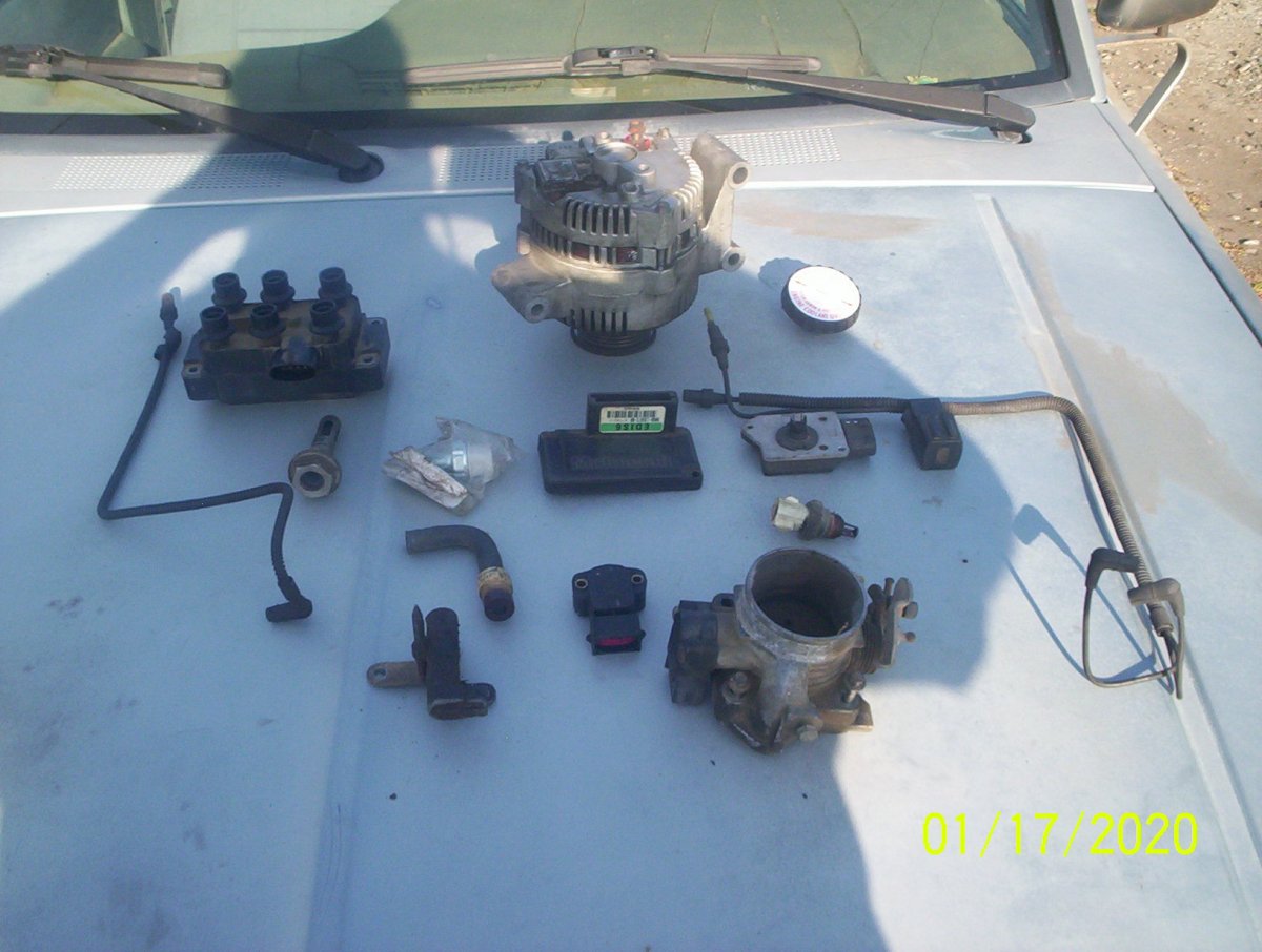

These are most of the parts that will keep your truck from running
Nice post man, it actually deserves its own thread.
One especially I wonder, what is that L shape one to the right of , and below of, the throttle body and alternator?
Looks to be the PCV valve and hose.
