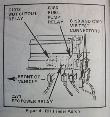

The fuel pump relay is under the power distribution box on the passenger fender well:

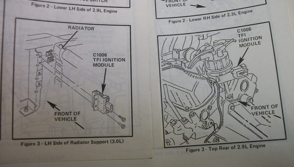

You're not sure of which engine except that it's a V6, of which three were offered in 1991.
2.9 (came in 4WD), and the 3.0 will have a Thick Film Ignition (TFI) module. 2.9- on the distributor.
3.0 will also have a TFI, but on the radiator support, LH front of engine compartment.

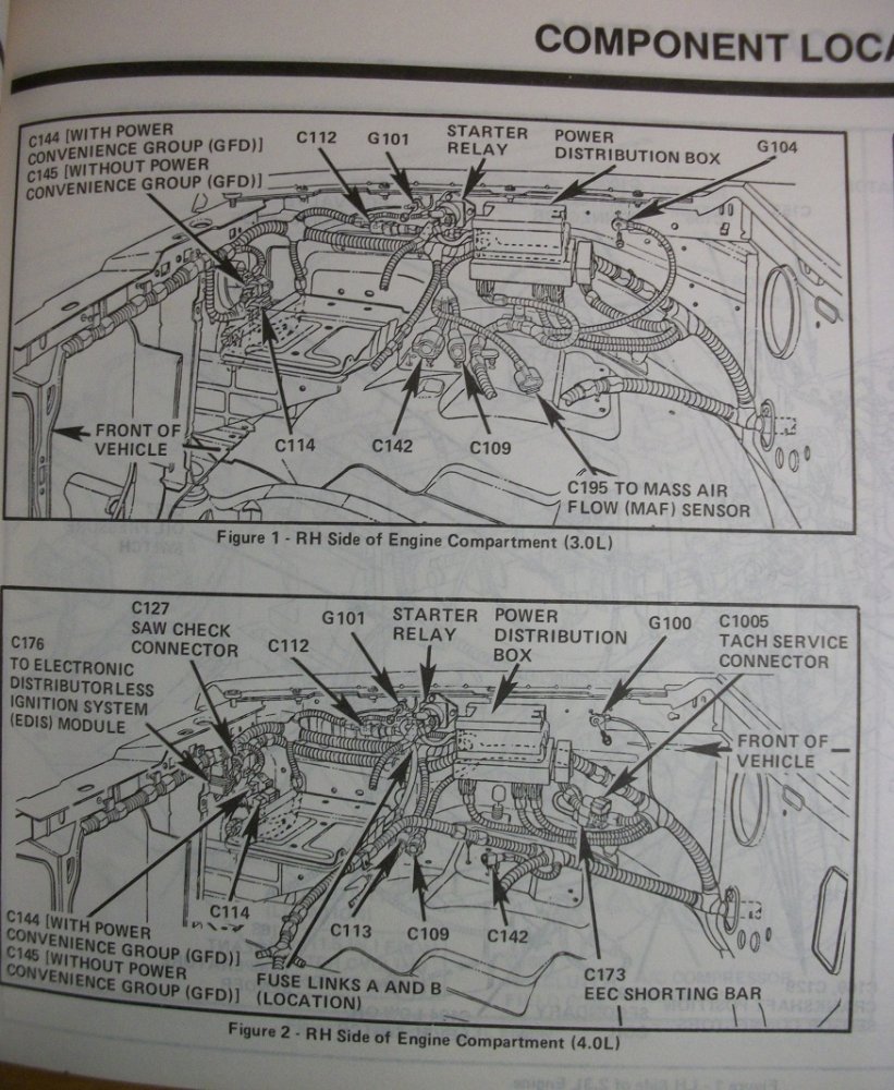

The 4.0 will have an Electronic Distributorless Ignition System (EDIS) module on the RH front of the engine compartment.
Locations:
36924
and
36925
