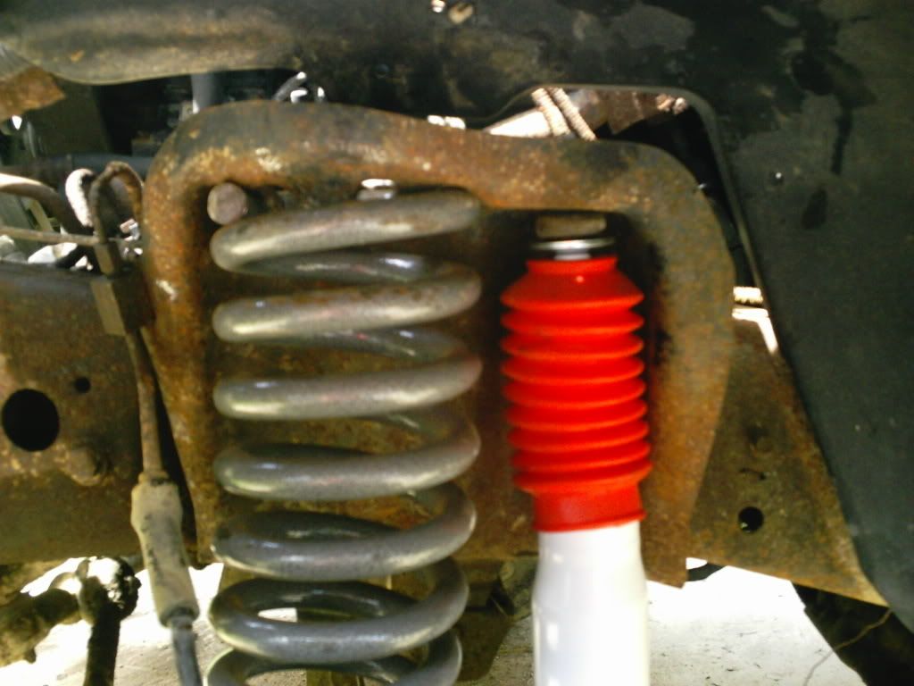

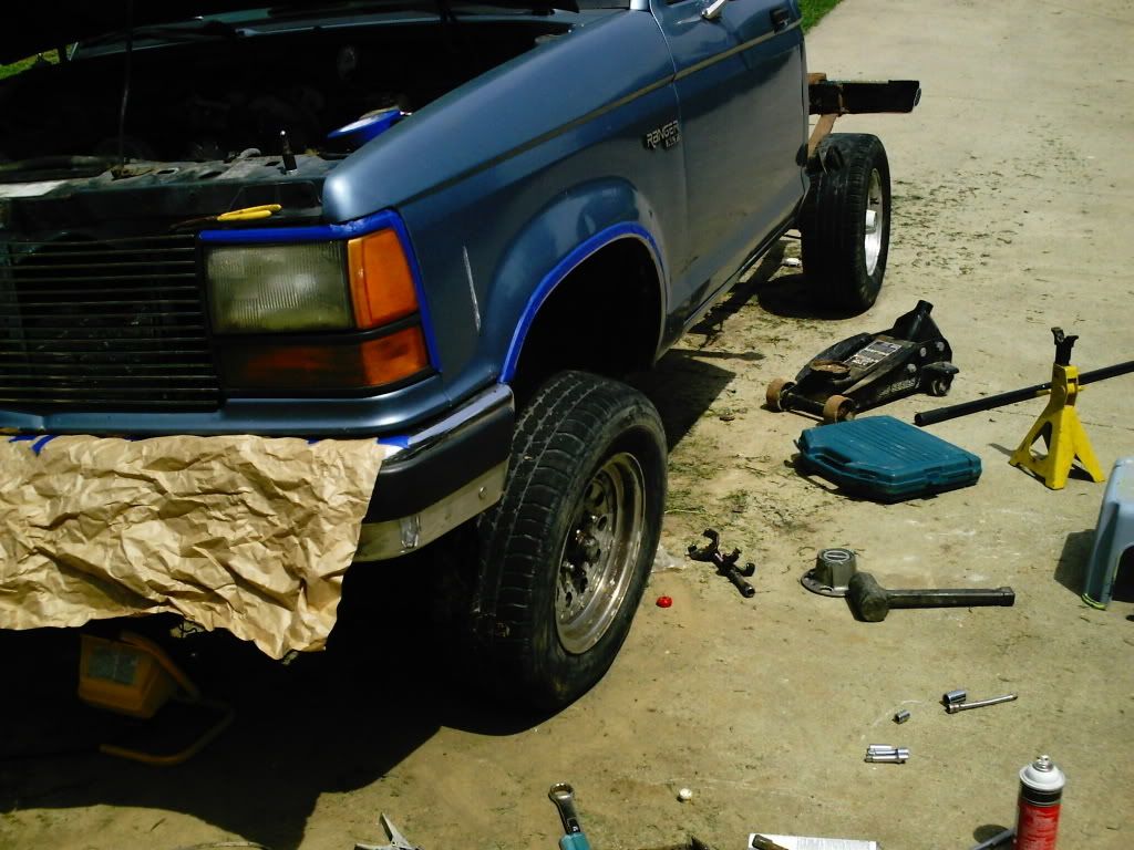

i pb blasted the hell out of it, lol. the impact wrench didnt have enuff juice to do it... my aircompressor must not be big enough. i broke a craftsman socket with my jack handle slipped over the end... haha. ill need to get my breaker bar from my friend tomorow. ill keep pics updated.
while trying to turn the breaker bar have some one smack the back of the socket with a hammer
heat helps sometimes
yah, i got all the bolts loose, i got a 1 1/8s hitch wrench with a piece of squared steel tubing as a cheater bar...
any help on getting the bolt out that connects the radius arms to the beams?? is it machined in?
I had to use a bit of heat on the bolt around the radius arms in conjunction with my impact on the bottom side to help break it loose. then i used a plastic deadblow hammer on the top of the bolt (with the nut on it to prevent thread mashing).
