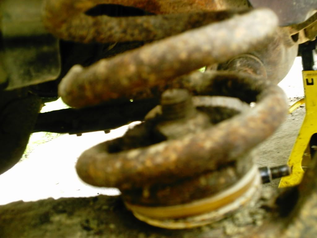

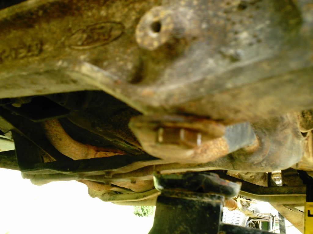

any tip on how to get this bolt out? its the coil spring bolt.. its killin me
some PB blaster all over teh bolt and nut, let it sit for a bit then if you got an impact gun, hit the bolt head with it and i should come free. If no impact, give her your all on a breaker bar :D
i pb blasted the hell out of it, lol. the impact wrench didnt have enuff juice to do it... my aircompressor must not be big enough. i broke a craftsman socket with my jack handle slipped over the end... haha. ill need to get my breaker bar from my friend tomorow. ill keep pics updated.
