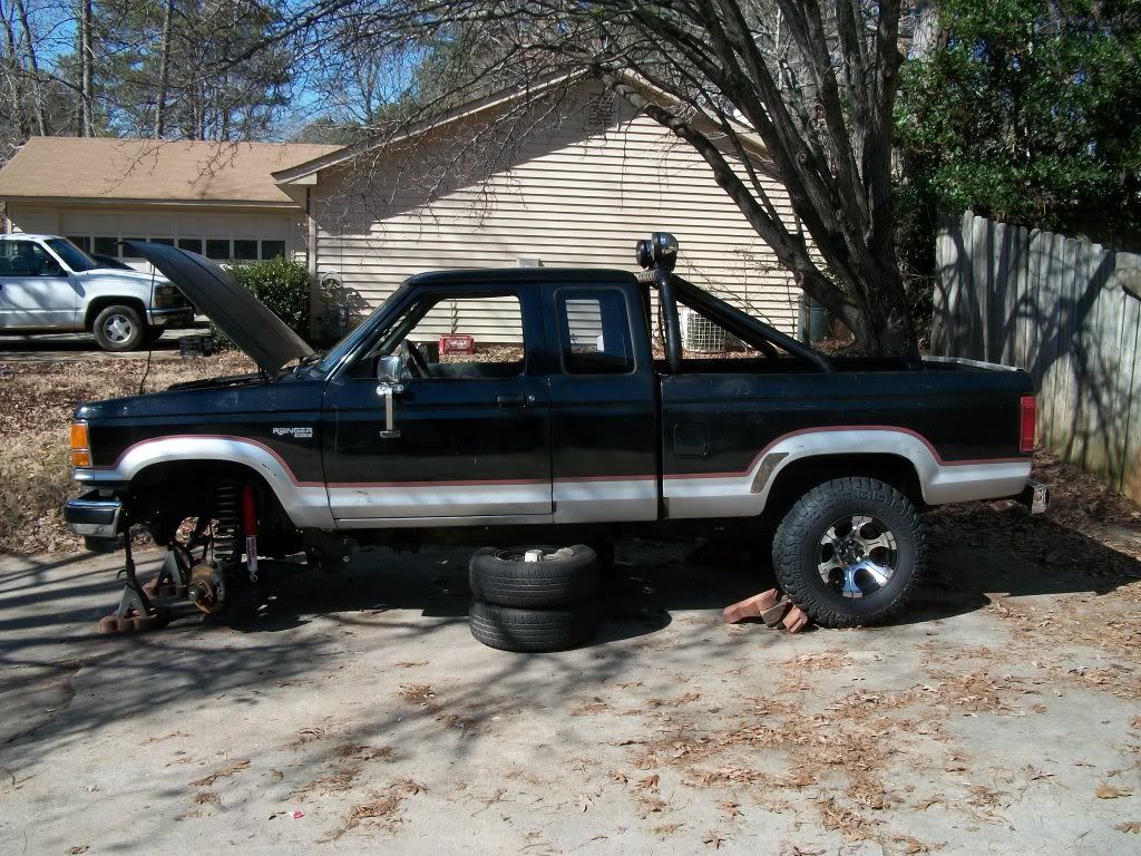

1990 Ford ranger Super upgrade
keep in mind I plan yo drop my front and read bumper and make my own with a winch included in it.

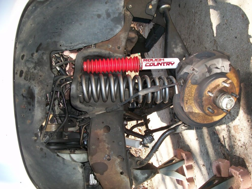

4 inch rough country lift and 3 inch body lift.

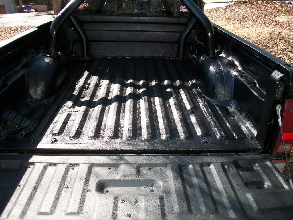

yes that is my bed coated in spray on bed liner~!

P.S. excuse my spelling, it been a long week and I have had little sleep haha. Quick question with the brake lines, in the front, I know I have to extend them but can i cut the middle hose in half and add a piece of hose in between it, would that work... or am I crazy? The only lines I have found are ones from summit racing that are 115$
That sway bar doesn't look right. I hope you are either taking it out or installing drop brackets for the swaybar.
ohh yeah, the sway bar not even connected right now haha, I got to drop it like a couple inches other wise it will mess with my steering arms.
NO. Don't cut your brake hoses. Either relocate where they come out from the body or get longer lines.
yea, i bought longer brake lines, so soon i should be able to throw the front wheels on
Oh and just cut and extend your swaybar links, get some tubeing and put each end in the piece you cut to length! I did that for the links on my 6" lifted bronco2

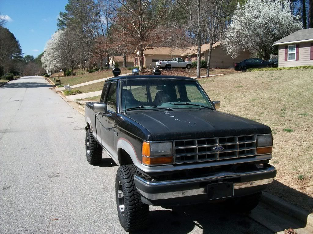

31x10.50 inch tires, 3 inch body lift, and 4 inch suspension lift
